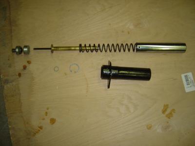

John, if you disassemble the hydraulic actuator, you'll find a very heavy spring mechanism that pushes the spoiler upward in conjunction with the hydraulic fluid. While your idea sounds like it would work, if you completely unbolt the hydraulic line form the actuator, it's default position is down not up. You'd think with the spring it would be forced upwards.
This is from the 996TT, but it is almost the same:

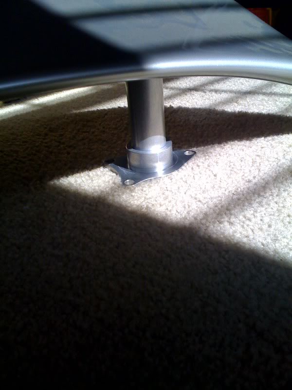

I was considering manually with a pin-support locking the expensive thing in the upper position and bypass all these costly parts and dealership time.....just let the system bleed down to zero oil as long as it bleeds only itself. The spoiler looks a bit stupid anyway in down position compared to up position.
Like this?

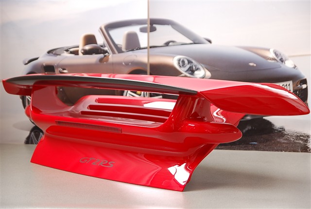

Interesting the GT2 wing is fixed. I guess that tube-light flat-bracket is from a GT2 wing shown above? If so, these brackets should be available at porsche. I would assume GT2 wing support pipes and turbo support pipes are same diameter. These brackets, however, would need some drilling (3 each) into the cars metal, whereas my idea with the cotter pin like solid pin would require only drilling the tubes in current wing-posts which sounds a bit easier. I guess key question still remaining is, is there a fuse just for the wing up/down??

Interesting the GT2 wing is fixed. I guess that tube-light flat-bracket is from a GT2 wing shown above? If so, these brackets should be available at porsche. I would assume GT2 and turbo pipes holding wing are same diameter. These brackets, however, would need some drilling into the cars metal, whereas my idea with the cotter pin would require only drilling the tubes in current wing-posts which sounds a bit easier.
John, the GT2 wing is a completely different design. It's a fixed carbon upright:
The uprights I posed were fabricated by a former sponsor from this site.

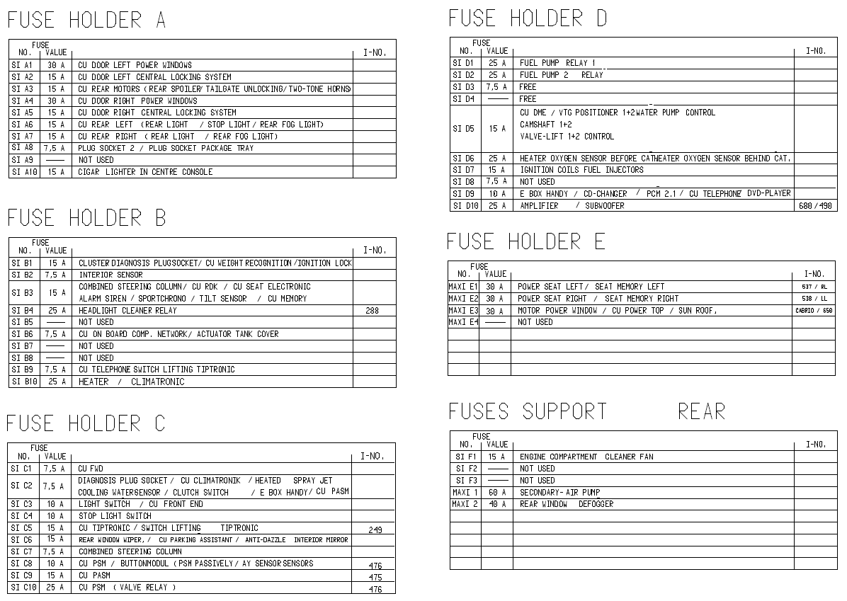

Not sure about the fuse - according to the fuse panel map, there is no specific fuse for the wing. I think it is tied into the other rear components (lights, turn signals, brake light, etc.) I'd just program the wing out with Durametric.
