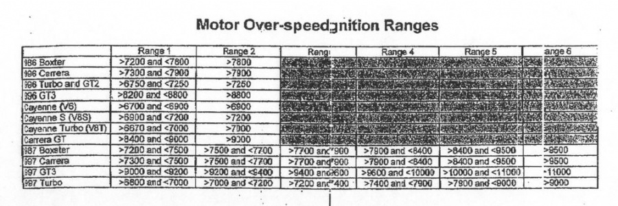

I am currently looking at picking up my first 997 Turbo and its had about $20,000 in engine upgrades taking it to 600-650BHP
I was warned about Over Rev on these cars as well as other bits and pieces so requested the computer printout of the Ingitions and would love some feedback.. Should I not worry or should I run?
The car has also had the RPM levels increased as was explained to me so thats why there are quite a few Ingitions in levels 1 and 2.

Most will say walk away based on the report. Range 5 revs are usually are no nos however it seems it happened several hours ago. With a rev limiter increase usually of 500RPM you can void rev 1 and 2 over ignitions. Do a search on the forum you will find many threads on this.

TRhe range 5 was at 263 hours and the car is now on 657. So it was in the first 1/3 of its life. Probably done when they were tuning it..
What do you mean re voiding rev 1 and 2 over ignitions?

Yes it was like I said most will walk away regardless but the choice is yours. Since the rev limiter is raised your by default going to get a lot of Range 1-2 over revs See attachement and good luck with your purchase

The upgrades cost quite a bit. From what Ive been told it looks like the range 5 ignitions at a count of 60 is exactly 20 revolutions which at the highest level of ingnition 5 (9000 rpm) we are talking about is 0.12 of a second at that speed and its more likely it was in the 7,900 region.

Do you know the specifics on the engine upgrades? If internals were upgraded, the over-revs likely have far less relevance than if the engine internals are stock. Range 5's, even remote ones, almost always make buyers uncomfortable.

One more thought... Although unlikely, I would make sure the "upgrades" we're not repairs. With stock internals, I might keep looking with the range 5's.

I called the tuning shop who had nothing but good things to say about the car and the work done to it. I also discussed the Range 5 blip of 60 and they looked in to it and advised me it was a very long time ago and such a small fraction of a second was not worth worring about.

Probably all true. Just keep in mind, when it is time for you to sell it, some buyers will have the same reservations expressed here. Obviously, that will be a diminishing issue as time passes. Ultimately, it is your call. Sounds like a nice car at a good price.

Chris-w below are two good reads regarding DME interpretation with opinions on what one would do or not do. The general consensus is there are plenty of cars out there with a clean bill of health, but I understand what it's like to fall in love with the wrong women, you know its bad but you want it anyway If you are really concerned you can have a leak down and compression test done of course at costs.
