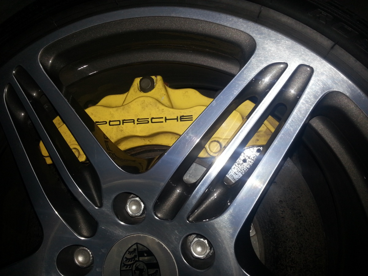

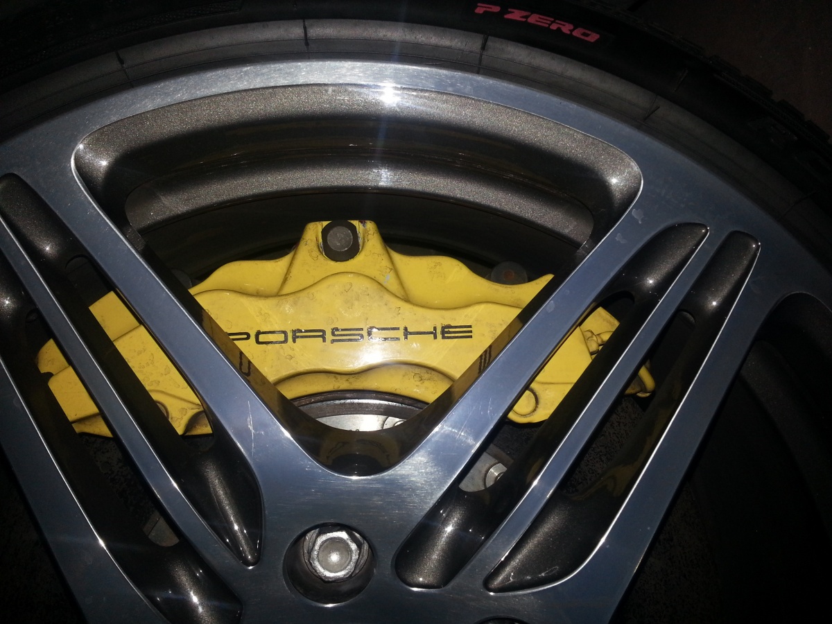

sorry for my repeated replies but something happens during upload of photos...
ID:	234470   Click image for larger version
ID:	234471   Click image for larger version

Originally Posted by pwdrhound
Please post a picture of your caliper/380 combo without the wheel, front and back. I'm dying to see this. Thank you.
I will do so in my next opportunity to lift the car...sorry i dont have any inside photos now...you can see low end clearance at close photo...

I am not in position to be aware of what went wrong when you tried to install 350mm calipers to 380disks...
Facts are facts and an engineering project is judged from its outcome...and guess what...we have two cars here with 350mm calipers running 380mm pccb disks...
upper and lower bolts are positioned in PARALLEL from the factory...so no matter how far or close they are spaced from wheelhub they will always be in parallel...I believe we both agree on that...
It really makes no sense to be able to space out 4piston caliper how far you like and not been able to do the same to 6 piston...SINCE THEY BOTH BOLT AT THE SAME wheelhub...
All i have to say is that when i was installing them i tried 15mm spacers and low end didnt clear out...So i tried 18mm spacers and everything was ok..
One of my photos shows crearly low end clearance from disk to caliper...i will photo inside side for you at first opportunity...
