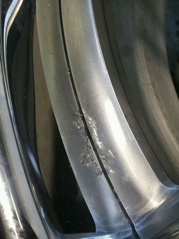

Sorry guys been busy with work just got back on this thread but yea -- its 360 Forged built by cor --- I have called Amex and they are dealing with the dispute now.
Another guy(saw this at the shop where work is being done to my car) who has 360/Cor wheels on his GTR and his bolts on the back of the wheel are not stainless steel and have rusted and his paint is peeling already. Can chrome peel??? Attached PIC
Not sure this is true but is stainless steal not magnetic?, according to my google search if its quality then it is not magnetic. Look at pics....
@WheelsBotique - I took the wheels to BullsEye and ArmorPowder in Fort Lauderdale both told me the tires where powder coated. However the way the wheel was powder coated is incorrect. The metal was not treated properly prior to application so the coating wouldn't have adhered properly during bake. Second from what they can see without stripping the wheel they screwed up the first coat and just sprayed over the first coat creating a second coat which didn't adhere properly either. They also said the type of paint used on the wheel would not hold up properly in the sun and would start to fade. Something polyster and .....

304 stainless is non magnetic but 400 grades are magnetic. Some 304 bolts can have a slight draw but a magnet wont stick.
Ive seen chrome chip off wheels....

another thing is when wheels arent powdercoated properly, with the heating process they will weaken and eventually crack.
