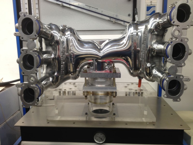

Hello Chad,
There aren't any flow numbers yet, i can share when i have a solid flow test results.
I'm also testing our new 90mm billet CNC manufactured throttlebody which is also compatible with STOCK ECU.
To be honest i couldnt see any difference on the road till 1.2 bar, i think there will be difference above 1.8 bar of boost. Will post in a seperate thread when i get the results with high boost.
Here are a few more pictures;

[QUOTE=Emre@Esmotor;4008418]Hello Chad,
UOTE]
Emre,
I actually believe you may be onto something with your intake. At the very worse once you get the numbers all you may need to do is tweek the shape of your two welded feed sides.
I know exactly what the Cup manifolds flows. It flows a good amount more than the GT2 manifold, however there are some issues not related to cfm. I would like to see your manifold's air pressure numbers measured at the runner exits with Pitot tubes. This measurement calculates the velocity not the CFM. However, in manifolds and head ports, velocity is directly related to flow.
There is an issue using a Cup manifold. This is why I would like to see your pressure numbers for each cylinder. I believe your center piece as designed may address what I already know with the faults of the Cup manifold.
If your manifold is balanced on all six ports and maintains flow I would be interested in purchasing one.
As for your TB. I'll give some free advice based on our tests. A 90 mm TB is nice for upper end power ..... at the sacrifice of lower end power at start. The big surge of air upon TB opening isn't good. Once opened it's nice. You cannot get around this with a single round TB of this size, but you can with an oval TB. We have tested both 95 mm and 105 mm Camero TB's and they work very well in all positions.
To give you an idea of what we have gone through, here is our build. We have left nothing unturned. https://www.6speedonline.com/forums/...-j-maring.html
Finally, if your manifold proves out I hope you have a patent pending as there are so many copy cats out there today.

Emre recently took me up on my offer to have his manifold tested for both flow and balance. He sent his manifold to the test facility who has done all my past testing. I paid for the testing.
I will let Emre disclose what he wishes about the tests. Bottom line is .... after receiving the test results, I will remove my other manifold and buy one of his. I only wish I had this manifold in my hands two years ago.

Thank you all guys,
I'm happy to see that manifold proved it self at an un-biased test.
I havent be able to test it on a bench but i made our R&D based on our acceleration test results on the road.
I'm still thinkin about a few tricks to improve it further more...
Here is a picture from the test;

Emre -well done on all counts-it is very interesting and even more so if you can explain the net results of your work.
The very fact you were prepared to have independent test completely blind is fantastic-- both in your own desire to see results but especially as you opened your work to the world .It is in sharp contrast with a few others who are not only defensive in promoting their products-- but actively seek to prevent testing!
