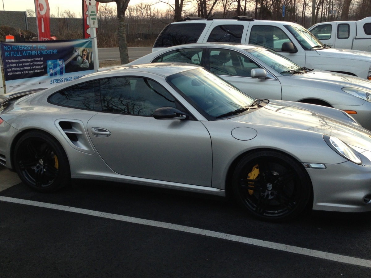

Ok, just had the Bilsteins, drop links and swaybars installed. I had everything set to your specs except the ride height, I lowered 20mm all around. I drove it for about 7 miles and here is my feedback thus far:
1. A bit bouncy both in normal and sport mode.
2. I made a left turn at normal driving speed and lost a bit of traction. Definitely oversteered. This has me a bit worried.
I'm taking it back to the shop tomorrow to make sure nothing is loose. A heard a little rattle coming from the front passenger side as I went over bumps but it could be my mind playing tricks on me.
Is this normal with this setup?
Looks great though!!! I figured it will make a few more trips to the shop before we dial the suspension in right.
Your feedback is greatly appreciated!

First congrats - stiffer is the way the Turbo is meant to feel for a number of Porsche enthusiasts (partly why guys on GT2/GT3 forum have nothing but disdain for the stock Turbo's softness).
1. Yes stiffer spring will always make a car feel "bouncy" and Bilstein is no exception. This is the law of physics: you are trading ride for handling and there is no way around it. That said, give it a few weeks, I predict that you will get used to it and it will become as the best daily driver you ever own. I've driven my car with Bilstein for 40,000 plus miles on LA streets and have no problem whatsoever, and I am not particularly young.
That said, there are other factors that will increase or decrease this stiffness:
A. What tire are you using and what pressure are you running? What does the differential TPMS read? 0 throughout?
B. Which sway bar and which drop link? What are your settings, front and rear?
C. Are you on 20" or 19" wheel?
2. Oversteer: Drive the car carefully at first and give it some time, say a few weeks. You will get used to it and will be able to make more accurate observation.
Unless you make sudden changes (braking in middle of curve, off throttle in middle of curve), for me it is *extremely* hard to induce oversteer at street speed in our Turbo, unless you are at extreme street speed of course. IMHO: you might be right but, as mentioned, slow down and give yourself a few weeks to get used to the new suspension setup; your observation and adjustment then will be more reliable, IMHO.
Pro's and very very advanced drivers give suspension evaluation and feedback in their sleep; for amateurs I think it takes us weeks to make reliable observation.
3. Rattle: Do have the car checked but yes, when you go over bumps in parking lot, the spring makes noise as it moves within the spring seats vertically.
Noise at slow speed, on bumps, and at extreme steering angle **may** be an annoying normal. (I think it's primarily the spring moving within the seats, but there have been other explanations proposed.) Noise at high speed, say above 10mph, and on smooth road, is never normal. Either way have the car checked by a pro to make sure everything is ok.
4. Ride height: Just make sure your measurement is accurate and it *is* only 20mm you are lowering. You have checked using the measurement method (this is the *only* way to make accurate measurement) in my Bilstein thread? Severe lowering alters the 3D relationship of the suspension links and may cause harm (altered suspension behavior, broken link, etc.). It's doable, up to around 30mm, but don't suggest ever lowering more than 20mm.
Good luck, drive carefully, and have fun. I am sure you already know "slow in, fast out" - universal truth that's even truer when you switch to a more aggressive suspension.

Thanks for the reply! I'm running PSS tires with 0 showing on TPMS and stock wheels (19"). My droplinks are Tarrett and sways are H&R. Sways are set to soft up front (farthest hole) and med out back (middle hole).
Question. They mentioned that they were going to align the car taking into account a 190-200lb driver (me). Did you account for the driver when you aligned your Turbo?
I dropped the Turbo off at the shop a few hours ago. The guys are going to look everything over once more to be on the safe side.
I'll provide an update as soon as I get back in the seat! As always, thanks for your support!
