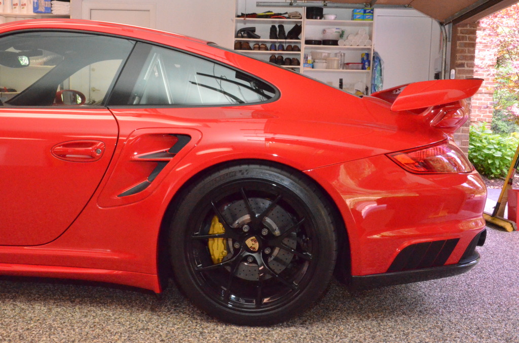

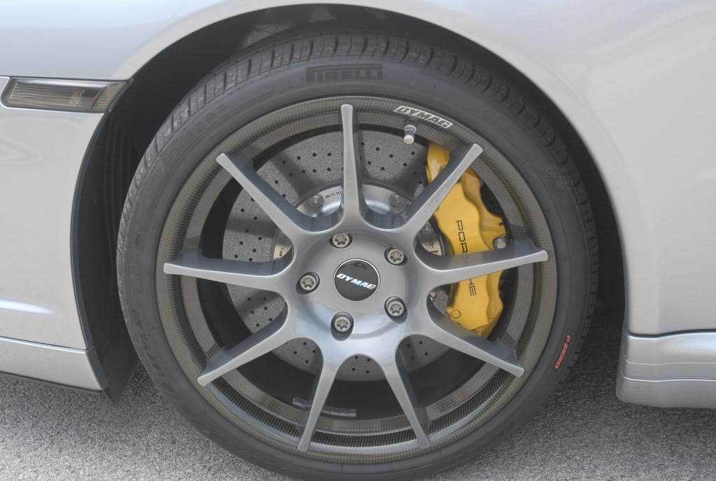

I've got a set of Dymags for sale. This picture is the "old construction" that had some cracking problems. Dymag swapped them for free to the new construction. The ones I now have are machined for Porsche center caps as opposed to the one in the picture that were machined for Dymag center caps. They are not interchangeable. I sold the car almost two years ago so wheels have been packaged and stored since then.

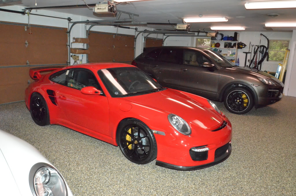

Too bad they don't make the BBS FI wheels for your fitment. I have them on my GT2 and love them.
