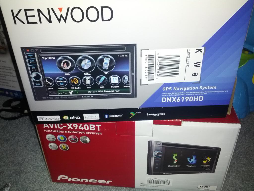

My only "complaint" about my "new" 997.1 Turbo was the PCM2. Clearly it wasn't a deal breaker but it would be nice to have a touch screen, better nav, and ipod connectivity. I also prefer to have a volume **** vice a full touch screen solution. I had looked at both of these units and am kind of on the fence. My girlfriend picked up both the Kenwood and Pioneer units for me for Christmas.
I don't know anyone with either unit to ask their opinion. I've found very little information online. One post stated the song titles would no longer display under the tach (I can live with that) but did not state if there was any other impact on the car. WRT the cars options I have the "thicker sport" steering wheel, adaptive sports seats, and sports chrono package. I called a local shop that stated there would be zero impact but the Kenwood was incompatible with the amplifier and they happened to have Pioneer units on sale. Bestbuy claims that both units will work in the 997.
I would greatly appreciate any informed opinions on whether to install one unit over the other or to keep the PCM and go with Dennison/NavTV for an ipod.

@za3879 yes sir they both have them.
http://www.kenwoodusa.com/car_entert...tion/dnx6190hd and http://www.pioneerelectronics.com/PU...on/AVIC-X940BT
They look pretty much the same, though I think I like the look of the Kenwood's nav just a *bit* more.
