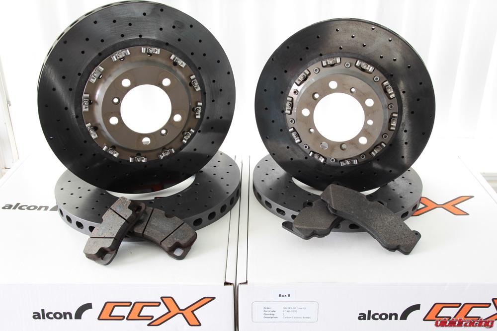

Old Feb 7, 2013 | 05:21 PM
vividracing's Avatar
Posts: 17,404
From: Gilbert, AZ
Dont forget you can also consider the Alcon CCX upgrade now as well.
Best thing is these rotors can be resurfaced as well.
https://www.6speedonline.com/forums/...s-porsche.html
