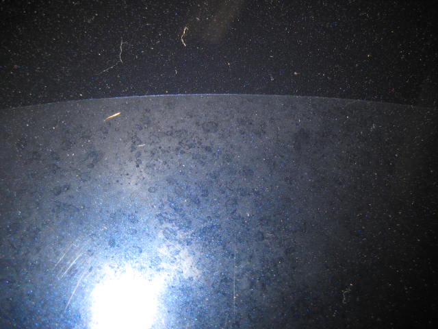

Here's a couple photogs from inside my garage. Not the best, but the car was washed a few weeks ago, dried and put away. I used Plexis on the bra.
The spots and fogging are obvious even with the poor lighting you can see the the difference between the film and the car's naked paint.

Yeah Bagger, that's definitely not normal. Glad your dealer is taking care of you. Show us some "After" pix once they replace it for you. I'm sure you'll be very happy and they'll be happy and deserving of some good publicity once they've taken care of it. Gotta give credit where it's due and it's nice to see them take care of you. Good luck!

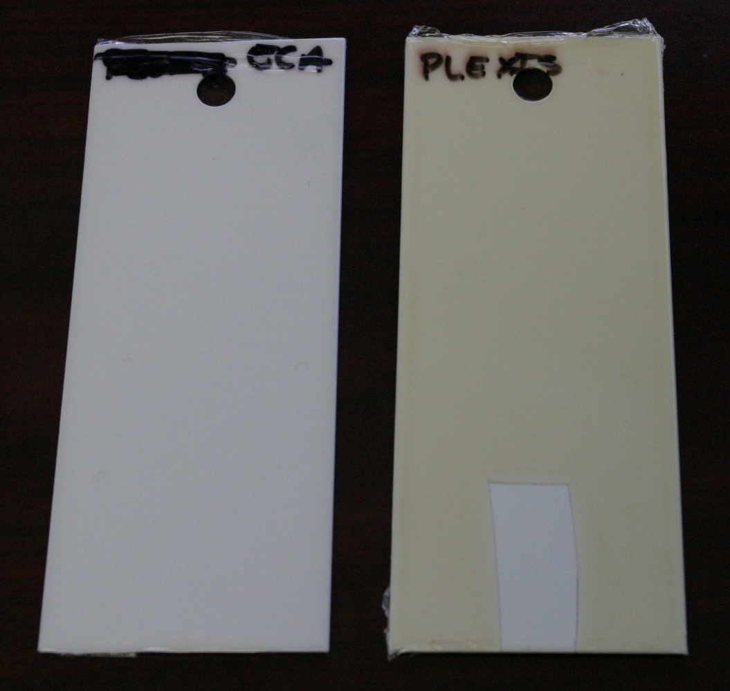

We can get you taken care of on the film and labor no problem. That being said, I can tell you from your first post what the issue is. Plexus contains 23% naphtha, which is EXTREMELY harmful to polyurethane. Plexus is made for acrylic and polycarbonate and is fine on those plastics. Here is a picture of two panels covered with polyurethane paint protection film placed through an accelerated weathering test. The one on the left was untreated. The one on the right was treated with Plexus.
Going forward, be sure to use sealants that are designed for polyurethane paint protection films. You can get ours at
http://xpel.com/products/tools.asp?p...rcare Products.
