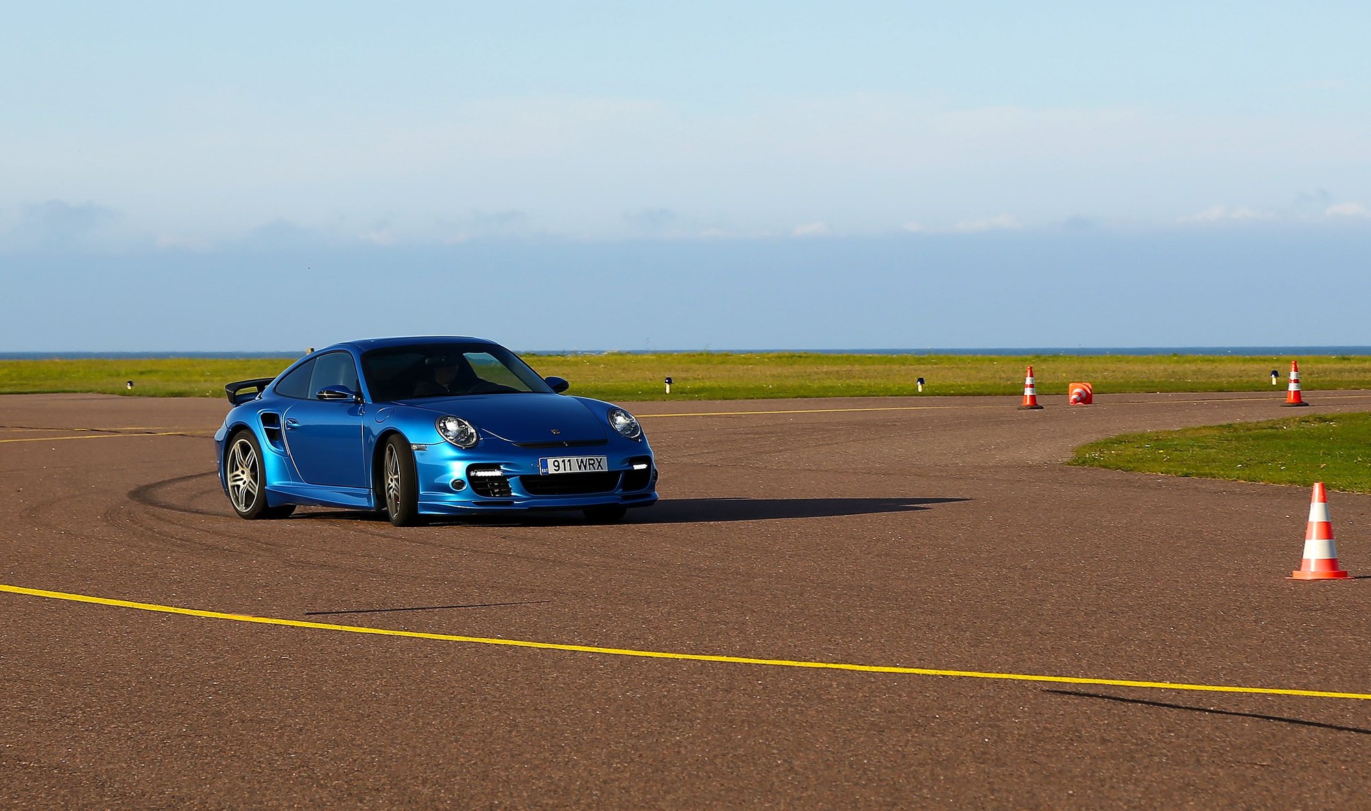

GT Silver is great color, but blue is sometimes better.
We wrap whole car with Avery Supreme Bright Blue Metallic wrap.

GT Silver is great color, but blue is sometimes better. We wrap whole car with Avery Supreme Bright Blue Metallic wrap.
Meh not a fan looks too Fast & Furious
