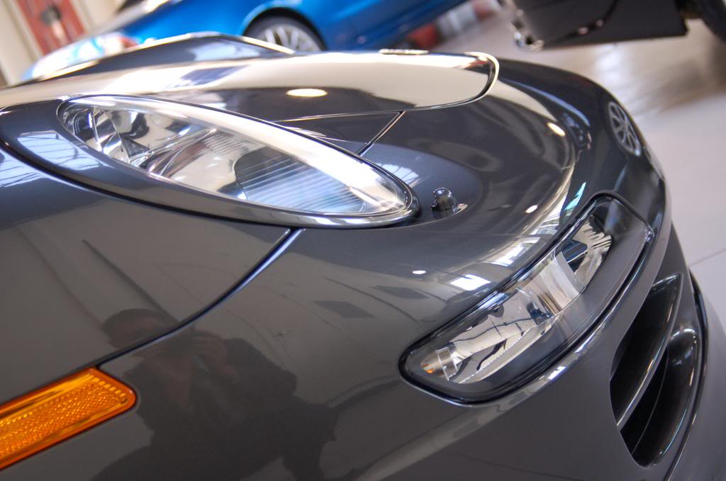

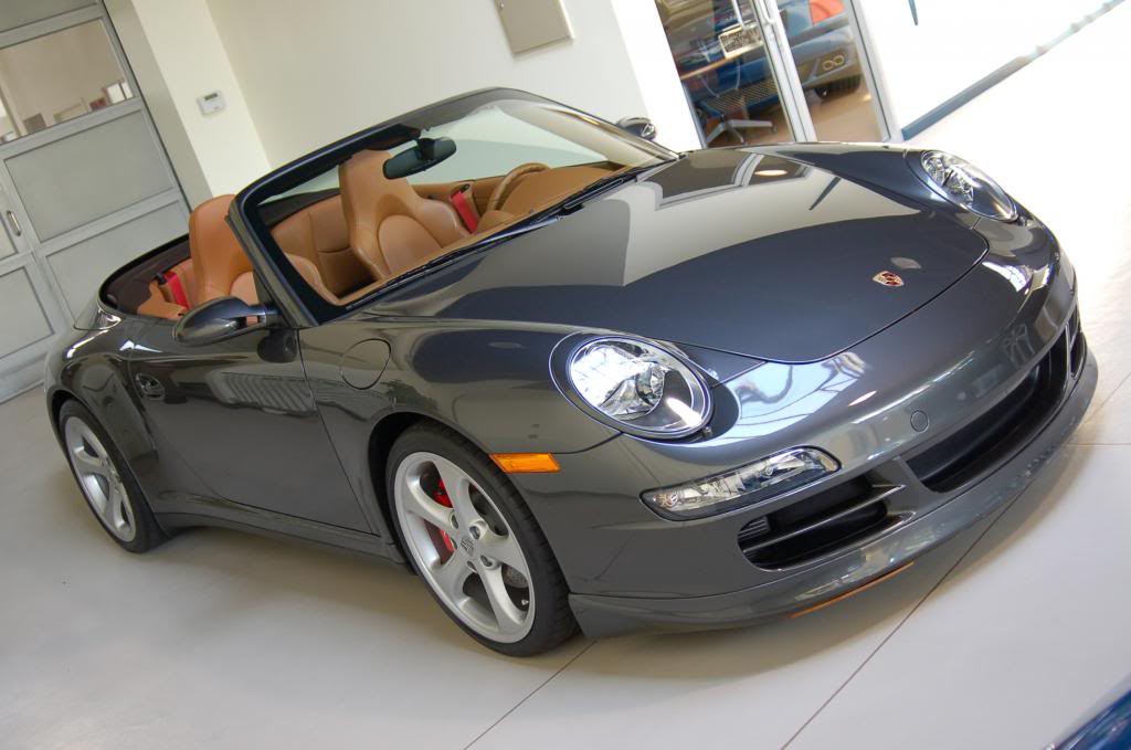

After 4 years I´m back in business After one of my friend crashed my old 996TT I have driven with 600hp Evo9 and M5 V10. But recently found one very good condition 997 turbo. It has only 17000 miles and bone stock, only Techart I exterior tuning. But it will not be like this too long. Other options are GT silver, 6speed, racechrono, diff. lock, full leather package, etc.
I am looking about 600hp from crank, planning straight pipes and dyno tune. Do I need to change clutch, diverter valves and spark plugs?
Some pics

Looks good love the pics in the snow, thats what you call really using your 911 as a daily driver,on another note how the heck do you guys get your pics big like this ,can someone pleas tell me ,for the life of me i can't figure it out,you'd think the robots would automatically do it like on other sites.

Beautiful 997 btw, enjoy it at good health.

I think the TechArt headlight rings would look great to finish out your body kit. I have them on my 997 C4S along with a lip and a small rear spoiler and I think the rings make the 997 look even more like a classic (993/964).
