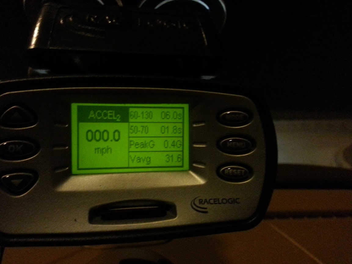

Well. Apparently I was just being silly testing the car in the 90*+ weather.
Borrowed the vbox, found a road with a .5% uphill grade, and clicked off one run. Didn't even bother doing any more and risking getting unwanted attention.
Log has been sent to mike for verification and will soon be on the official board. 6.02 60-130, 5.1 100-200. I'm sure had I done a few more runs that there was a 5.9X 60-130 in her. Maybe another day.
Also did this 4th gear only, so at 60 its not at full boost yet. I'll go try a 3-4 another day in an effort to get into the 5 seconds.
Still stock wheels so there's another bump in time if I ever buy lightweight ones (I wont lol)

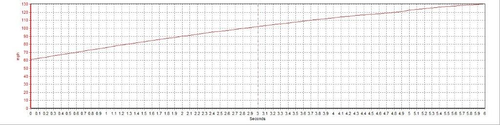

Great time! That's almost a full second from what I could do with 63.5's/MS109/4th gear pull.
PS Just noticed but your peakG's and velocity seem odd?

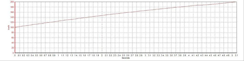

Here's the charts for 60-130 and 100-200.
It was a long logging session - drive to the road, ensure no traffic, do a run. I aborted the first run, so drive around and go back to the spot and go again. Didn't stop and have it reset during that time, hence the low avg.
Peak G i'm not sure why its showing .4. In the data, during the run its got .819.
