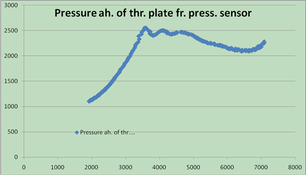

Logged my car last night and it is completely maxing out the stock turbos.
Around 5,000rpm you can see boost start to drop off - the tune is requesting ~2500 hectopascal, but the engine is flowing more air than the turbo can supply so it is dropping off.
As RPMs rise the volumetric efficiency is dropping off, and the turbos are starting to catch back up with the demand around 6500rpm.
The log is in absolute pressure, so you have to subtract atmospheric pressure from the value to get the boost value. In this case it was about 990hpa ambient, so peak boost was around 1560hpa or 22.6psi. However as it fell off around 6000rpm it was only making about 16psi. It's probably giving up somewhere in the neighborhood of 100-120whp to Chkmgnt's car with the 67mm VTGs which is able to maintain boost through the rev range.
Anyhow, thought you guys might find that interesting. Above 5K it doesn't really matter what I do, the turbos don't have any more flow left to give.
