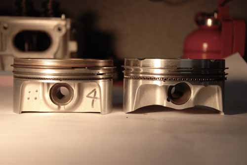

Protomotive custom 3.8 sleeve and piston set.

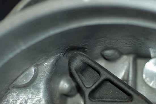

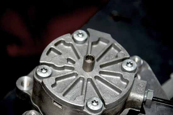

Oil pump bearings showing some wear after 5000 miles.
Old May 19, 2013 | 11:55 PM
SeattleBum's Avatar
Joined: May 2008
Posts: 1,035
From: Bellevue, WA
Rep Power: 73
SeattleBum has much to be proud ofSeattleBum has much to be proud ofSeattleBum has much to be proud ofSeattleBum has much to be proud ofSeattleBum has much to be proud ofSeattleBum has much to be proud ofSeattleBum has much to be proud ofSeattleBum has much to be proud ofSeattleBum has much to be proud ofSeattleBum has much to be proud of
Great pix! Keep 'em coming.

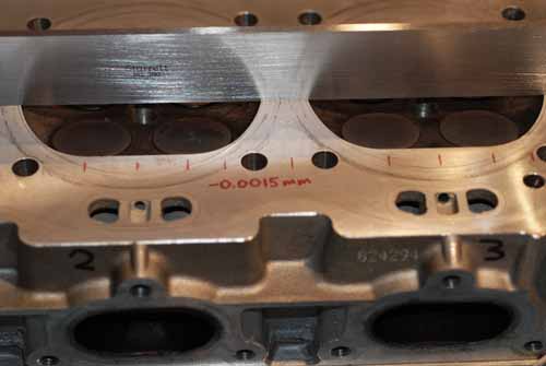

Thanks! Here's a couple more.
Measured head for flatness...Stock is pretty good but there was a sightly low section.
Along cylinders 2 & 3....
Sent heads to Protomotive for flycutting and o-ringing. Lighting not the greatest - shadows are amplified but head is perfectly flat all around. His o-ring work is masterful.

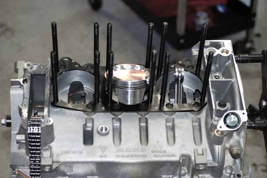

More progress.....

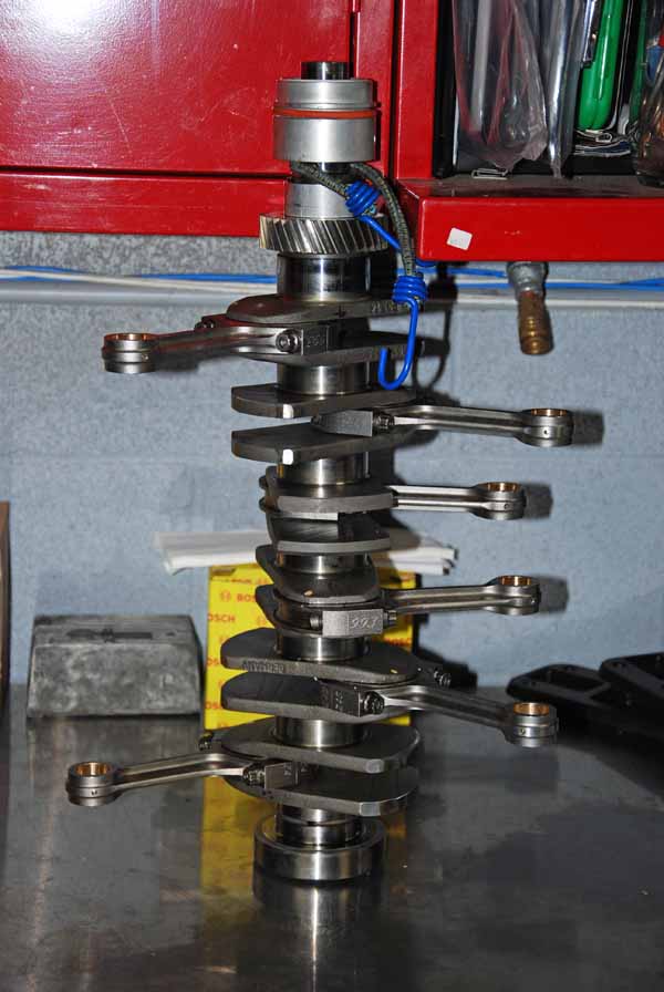

Rods on crank
Custom Cometic 3.8 base gasket vs stock
Installed...

Old May 24, 2013 | 08:57 AM
SeattleBum's Avatar
Joined: May 2008
Posts: 1,035
From: Bellevue, WA
Rep Power: 73
Artwork!

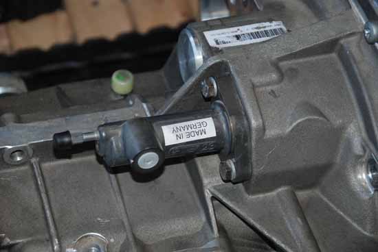

GT2 Slave conversion....
Stock Slave...
Bell housing drilled/tapped....
GT2 slave installed...
GT2 slave rod...
Added clearance for clutch fork....
Power steering pump coupler removed...
Clutch accumulator lines plugged....
