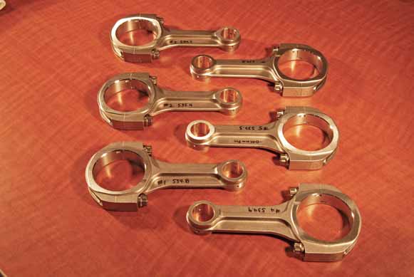

3.8L Build Started
Decided to go 3.8. Stock rods+ A3076+1.8 bar = souvenir
House Automotive is doing the build. These guys are exceptional. Will post more pics in due course. Stay tuned...

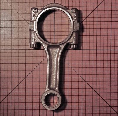

Originally Posted by DARTH-VADER
Are you using stock rods for the build ?

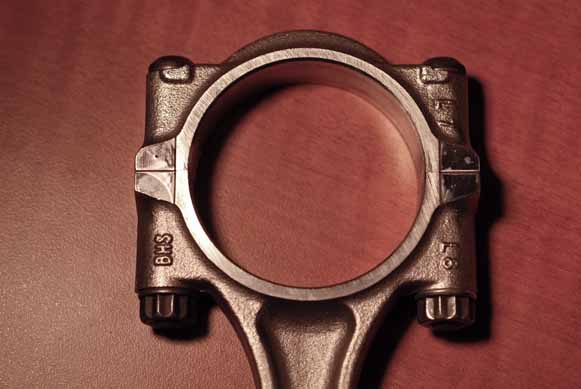

No, stockers are decent but not that stout. Rockwell test ~25, like butter the guy said.
I'll be using these beauties...

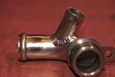

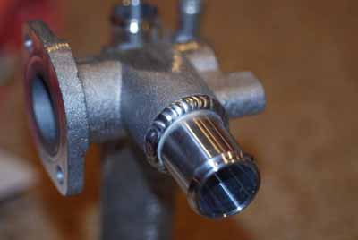

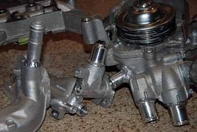

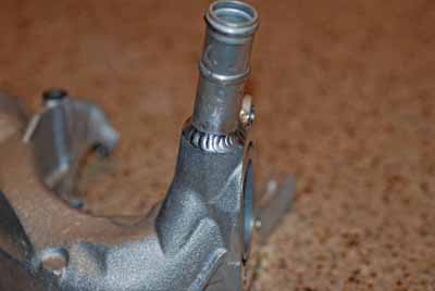

Just got my coolant pipes welded at BBI. Very nice job! Thanks Betim!

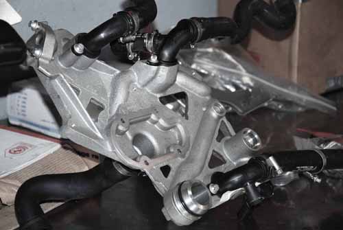

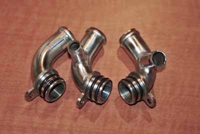

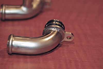

Yeah, really guys. If your coolant pipes leak you will have to pull the motor. I think it's listed as a 12 hour job. As a measure of further prevention, I picked up a set these stainless steel beauties from Sharkster to replace the stock plastics ones.
To replace these:
