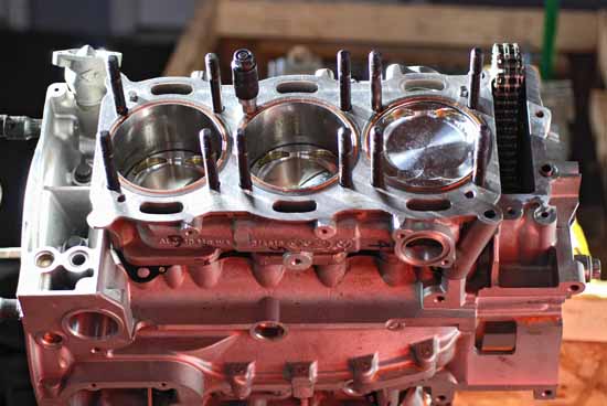

Sleeves/pistons installed....

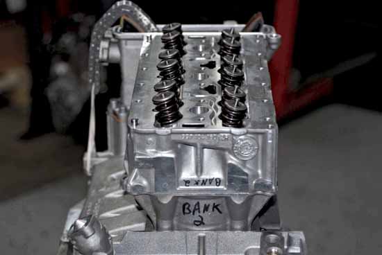

Heads installed....

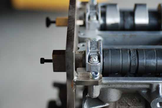

Cam timing...

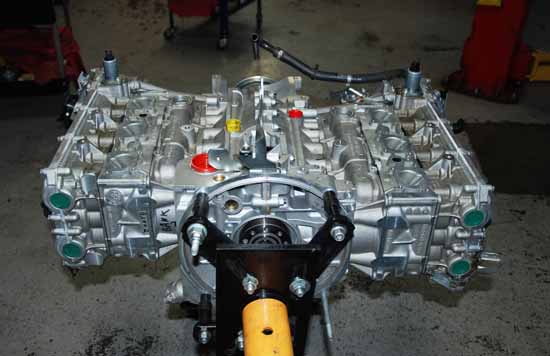

Motor assembled!

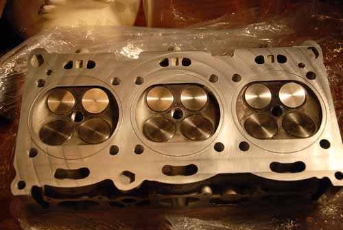

Originally Posted by TTdude
Sent heads to Protomotive for flycutting and o-ringing. Lighting not the greatest - shadows are amplified but head is perfectly flat all around. His o-ring work is masterful.
will the oring material be copper or stainless wire?
and is just the head grooved or both the block and heads?

TTdude Is a GOD !TTdude Is a GOD !TTdude Is a GOD !TTdude Is a GOD !TTdude Is a GOD !TTdude Is a GOD !TTdude Is a GOD !TTdude Is a GOD !TTdude Is a GOD !TTdude Is a GOD !TTdude Is a GOD !
Steel on heads and copper on sleeves.
wow, do they end up both touching when compressed or is one done at a slightly larger diameter than the other?
I was always under the impression that you usually did one of the other not both. I know the block is the best way and typically some would do the head if they did not want to send the whole block out.
They are designed for use with the stock gasket which are grooved. There is no block, per se, so it's the sleeves that get o-ringed.
