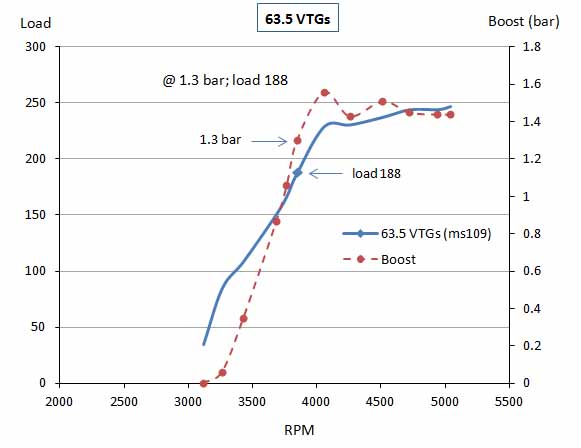

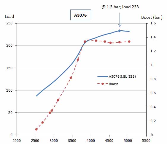

Collecting some preliminary data and calibrating Greddy: 63.5 mm VTGs (race gas) vs 3.8L A3076 (E85). At 1.3 bar, A3076 produces load value of 233 whereas my previous VTG set-up produced 188. That's basically a 24% increase in torque at 1.3 bar! I can't imagine what it's going to feel like at 2 bar. Totally ridiculous.
Greddy seems to be fairly accurate, definitely within 0.1 bar vs Durametric reading.

Assuming you're running speed density (no MAFs) then load is no longer useful. It's a calculated value and by removing the maf from the equation, it no longer can calculate properly. So while very cool - you're not actually showing anything on the charts. Obviously its making much more power/tq, but you'll need a dyno to really demonstrate the change.
Interesting comment. It has been dynoed and results are comparable but please elaborate on your commment that load is no longer useful by removing the maf sensor and that it can no longer calculate it correctly, whatever correct means. Please tell us how does the ECU calculates load with maf values, i.e. what is the exact equation? With the maf removed, it still outputs a load value. It is obviously derived from somewhere. How is it determined then when the maf sensor is removed? For that matter, how does the car run with the maf sensor removed?

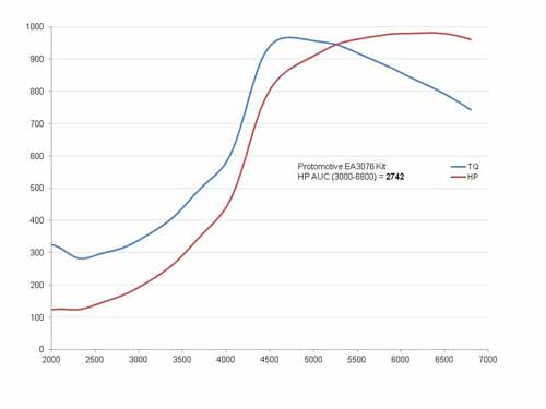

I might have missed it somewhere but what kind of whp are you expecting with this setup Dave?
I ask because we'll be starting a nearly identical build in the next few weeks...

Tom, When it was on the Dynapack at Proto, stock motor produced about 980 whp (I know, some will say it's a Dyanapack and blah, blah, blah about the absolute number). You obviously know this but if you tune to A3076 E85 to the max, stock rods will not be happy. Maybe one can dial in the tq later but what fun is that? I'm slowly ramping up - measuring everything, fuel trims, mult correction, etc... Last thing I want to do is crank it up all the way and have something not work right. It did take a long time but I had some unrelated issues with PCNA that involved legal action. Before I could put my motor back together that needed to be resolved. They lost the lawsuit but then they appealed. I couldn't believe it. They just wanted to drag it out. It was just me flying solo (I'm not an attorney) against the regional PCNA tech rep plus a PCNA lawyer wearing a cheap sear sucker pinstripe suit. They really tried to pull some shinanigans on me during the appeal. It took about 7 months to resolve due to court scheduling, but in the end, I took home the bacon. It was worth the wait.
I don't know how to analyse it too Dave:
I checked my logs: my engine reaches 188 load at 3700rpm by 1,06 Bar and 233 at 4700rpm by 1,33bar with pumpgas, 3,6liter and 3071s...
I believe too we can compare the loads at the same rpm ranges to estimate the torque, but not at the only same boost ranges.
