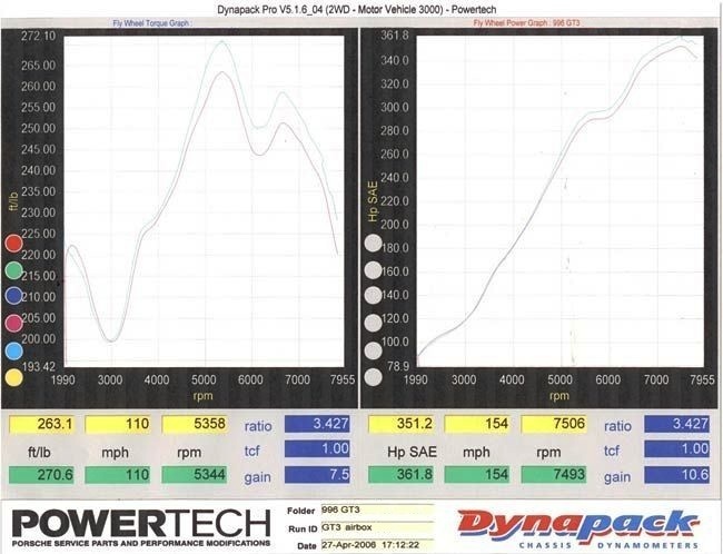

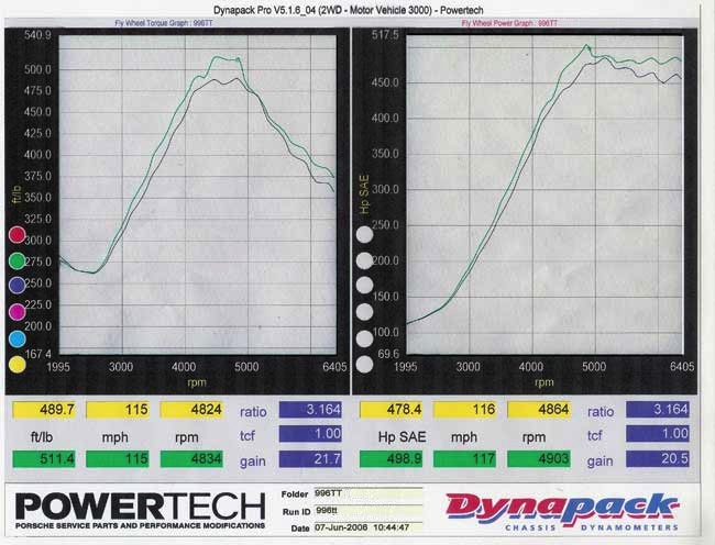

Originally Posted by bbywu
Sorry. Missed this. What do these graphs relate to? I see they refer to GT3 air box...
Dyno runs after replacing the filter elements with a cotton/oil replacement. One for a N/A 996, one for a F/I 996.
What does sharky say? He dyno'd and found zip so he says. I guess these graphs came from a BMC supplier lol. Love to see the OP's graphs....and Alex's. Then we all may have something more relevant to view given these cars were 997tt and 997GT3 RS.
