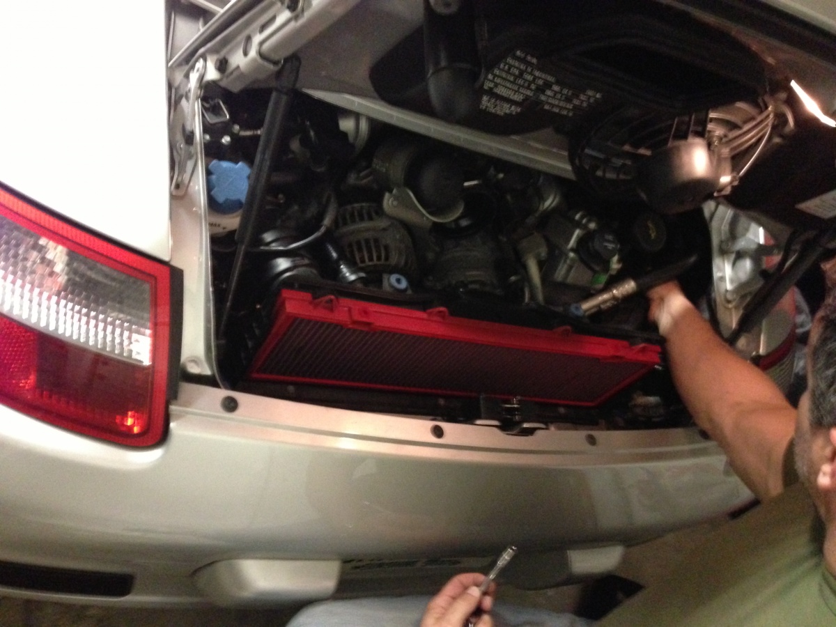

BMC Air Filter
cheers.
I'm really but really glad that i sold that system already (on ebay)
I'm back with the original intake and BMC air filter. I really like it so far, i'm not sure if i gain any hp but the car feels better.
