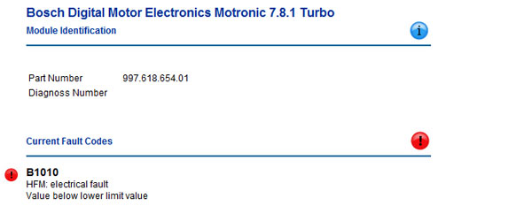

The new (and worse) issue you are having is obviously something new all together
Possibly- after thinking about this for awhile though this may be the result of the car just adapting until there's no where else to adapt to (i.e. fuel trims pushed to the limit)- then it goes bonkers. It could all be part of the same problem. I dunno- I reset the ECU so I've got awhile before it happens again. We'll touch base and you can give me some ideas.

Try looking at the FPR. The fuel pressure regulator has two fittings...if either if those is lose or completely off, the car is going to act up. Hopefully that will be the issue. If you find thins is the case, disconnect the battery, clear the code and see if that fixes the problem. I have a feeling that is the issue...
Thanks, seems like a good lead. Not a simple thing to get to though.
First things first - I think I damaged my MAF sensors when I cleaned them (I used CRC MAF cleaner). They may have had a previous issue (having been possibly damaged by an oversaturated BMC filter). Here a fault from a Durametric tool:
I ordered some new sensors but they won't be here until next week. I'll take a look at the FPR then. In the meantime, after throwing another CEL (8 codes), the car's in storage- we're taking a little break from each other. I have an appointment with a reputable semi-local shop on June 11th. I think that's probably when this will actually start getting sorted out.

If you remove the air box and stick your hand on the right side, you can actually feel the FPR with your hands...by tact, you can tell if both ends are connected.

Okay, quick update. Not the FPR, but it was a good idea. New MAF sensors didn't help. And my many tears and prayers also failed to solve the problems.
The car finally got so bad that I had to take it somewhere. I dropped it off at a company called RaceCo (inside the Miller Motorsports Park in UT). They were recommended by EVOMS and so far they have been exceptional.
They found a leak in one of the intercoolers. It was big enough that they couldn't really even pressure test the system to look for other leaks. The hole - I guess a crack along one of the welds - was bad enough that they were not able to fix it. So, two new EVOMS Gen 2 intercoolers inbound. After they are installed the pressure testing will resume. The "good news" is it the kind of leak that could be the cause of all my problems. The bad news is that it was not discovered in the PPI (to be fair, maybe it wasn't there at that point) and I've been driving the car around possibly doing more damage (i.e. overtaxing the turbos).

RaceCo has my new intercoolers installed and they are hopeful. They have pressure checked everything and there aren't any more leaks. Idle is stable and long term fuel trims are staying at +1 so far. They still have more testing to do, but I think we're on the right track (pun totally intended).
No idea what's up w/ the sport button yet, but it's clearly not working. Having talked with other EVT 775 owners they have indicated that when the sport button is pressed boost pressure and throttle response rise (anyone who has an EVT anything is free to chime in here to let me know what their sport button does or does not do). Hopefully EVOMS can help RaceCo figure out if the button worked at some point and determine why the button isn't working now.
