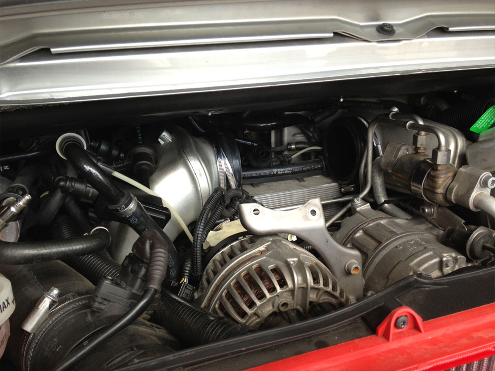

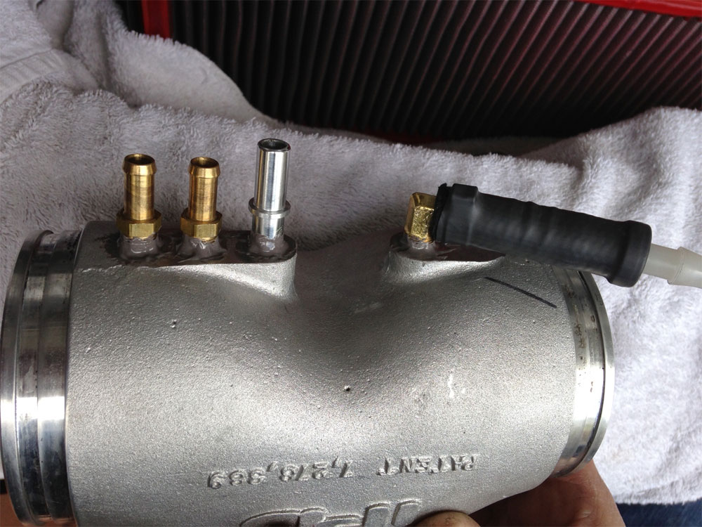

Okay, quick update. Robert (EVOMS) called me the the other day. He said other EVT builds had been having similar issues as mine and said they suspected the IPD plenums used in some of the newer builds had leaks around the fittings. On the back of the plenum are four metal fittings that are screwed in (well, one is pressed in). He told me to take out the plenum and JB weld around the fittings to make them air tight.
I'm used to working on my Chevy's so this was interesting (not a lot of wiggle room) but I got it out okay:
I took out the fittings and JB-welded the threads and then, once they were reseated, coated around the exterior. They didn't seem like they would leak but who knows (just bare threads when I took them out- no sealant or anything so maybe).
More interesting to me were the zip ties used on some the hoses going to the fittings. I don't trust zip ties so I replaced them with hose clamps. I also reseated some of the other clamps since they weren't adjusted quite right.
Wonder if it will make any difference? I'll find out later I guess (once the JB Weld sets). I did let the engine idle a bit and it seemed nice and smooth (but these things can totally be in your head- I know). I hate doing things that don't help...

Actually Robert mentioned your car. He said your plenum was one of the things that was leaking (based on my recollection). What CEL does your car throw? I hope you can get it resolved- if you do please let me know where they ended up finding leaks.

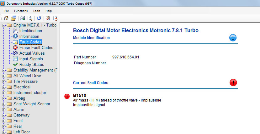

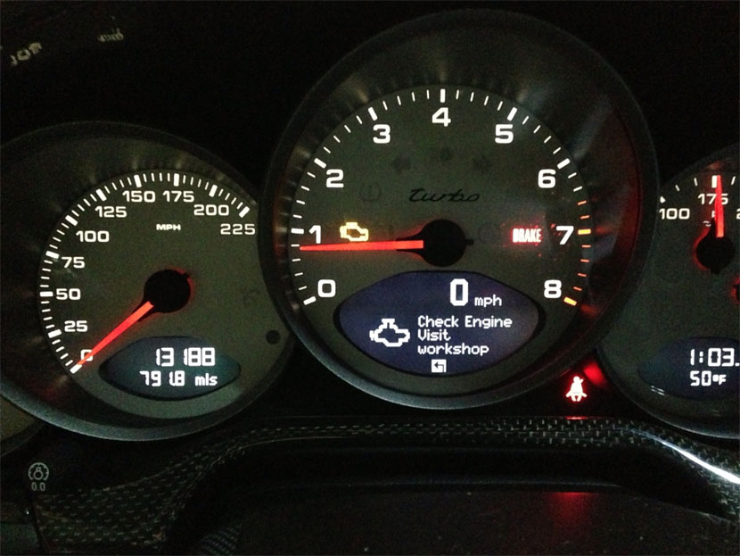

The saga continues (I know, I know- I need to do a comprehensive air leak test). Ran a quick errand last night and the car started going a bit nuts. I have driven this car nearly every day- nothing special about the drive last night. Well, except this:
When rolling (in neutral, foot off clutch):
The idle got stuck at about 1100 RPMs too (this is stopped, in neutral, foot off clutch).
I knew what was going to happen next:
At first the OBDII port was totally unresponsive- I could not communicate with the car at all. I locked the car, let it sit for a half hour or so and gave it another shot and it was working (has anyone ever encountered something like that?).

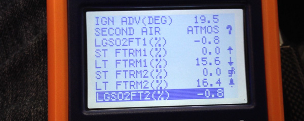

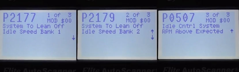

Pulled from a code reader:
And the Durametric info:
I feel like maybe I'm looking at something bigger than an air leak... any other ideas (I will still do the pressure test, but maybe there's something else I should be doing as well)? Anyone seen anything like this before?
