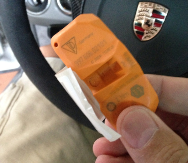

Just a follow-up on this issue. I finally got it resolved by putting in OEM TMPS sensors (part number 997 606 021 01). Zero issues since I installed these:
The sensors before were ITM (which was aggravating because I had paid for OEM sensors) and they just never worked right. I know some people have had good luck w/ them, but they were nothing but a headache for me.
I also realize that some people have issues with the OEM senors, but this was the solution to my problem.
