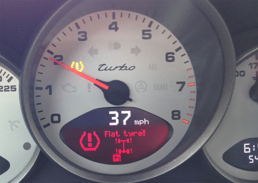

I hopped in my car today and was greeted with this:
After driving for a bit it seems to go back to "normal"
Obviously I checked the tire- it was a-ok. Is this indicative of a bad sensor, depleted battery, etc? Before getting the car I paid to have all the tire sensors replaced- I'd hate to think they didn't do that.
Thanks,
Cam

I think the sensor is failing. Tire rack has them, about 400$, eBay about 200$. They can be installed wo dismounting the tires. Runs about 85$.

I would stop by the dealer or local Discount Tire. They have scan tools that can read your sensors in seconds and tell you if the sensor is functioning properly, e.g. battery life.

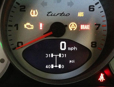

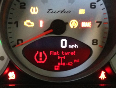

I took it to Discount Tire and the checked the sensors. Discount is not able to check battery levels (can Porsche dealers?), but the sensors all tested okay. I reset the system and it was okay for a bit [EDIT -->] but the error came back this evening.
After a bit more research I'm leaning toward the sensor being faulty. It's sending info but it's wrong (-42 pounds of pressure?). I dunno. Life would sure be dull if everything worked right

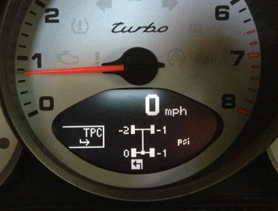

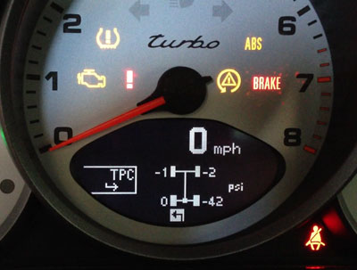

Okay, update- the company that put in my tire sensors was nice enough to send me a new one. I installed it, had the car relearn the sensors and everything seemed fine for a few days- no issues. Today this screen popped up:
I reset the sensors and the same screen popped up again. The pressure in the tires is correct. This is not a case of the sensors being old (they are new). What the hell? How many gremlins can this car have.
Has anyone seen this screen before? Anyone have any idea what's going on?

Hey there, I know it's frustrating. From an earlier post I know you're not favoring the dealer but that would be my next stop. See if you can chat it up with a service advisor and get them to check it quickly. They have the tools and knowledge to quickly diagnose this.
You may also try to call a few dealers tomorrow and see if you can speak with someone who has some experience. Explain the symptoms and steps you've taken to this point.

I should also mention that I found this on another forum and have tried it with no luck: "Select another tire combo - let it start to "recal" then select YOUR tire combo. The system will reset to your wheels and you will be fine."
I don't know- maybe. Last time I took it to them I got it back with three problems I didn't have before (and they weren't even able to help with the issue I brought it in for).
