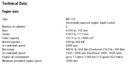

Originally Posted by xbox_fan
Hi,
I have not experienced anything wrong with the engine more than it is quite thirsty for oil in 9 months and around 2500miles it needed 1l (1/4 us gallon) of engine oil, but maybe that is normal (the car has done 40k miles).
Yeah - don't worry about the oil...
from the owners manual...
(note oil consumption)...
Your attachment is for the 997.2 3.8 engine (non-Mezger) - OP has the 3.6 Mezger engine. I have no oil consumption on mine (2008 turbo).
Valid point - sorry about that. I generally use that manual for the easy stuff.
I have a 997.1 - so the 3.6 - drive it fairly hard and track her 4x/year - I go through a liter every 1k - 1,500 miles or so depending on time of year. She is not abused...but enjoyed!
thanks! and omg up to 1,5l/1000km that would be a noticeable cost almost
ok, wrong engine, but I guess 1l 4000km is not a reason for concern...
