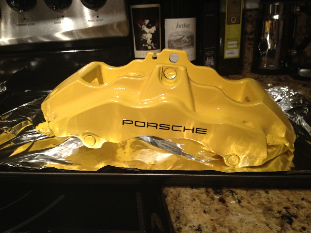

I did some baking last year and I have been dragging my feet on sharing the "recipe" here with 6speed

nice! but I prefer the red cookies.

Not on a yellow 911 though!

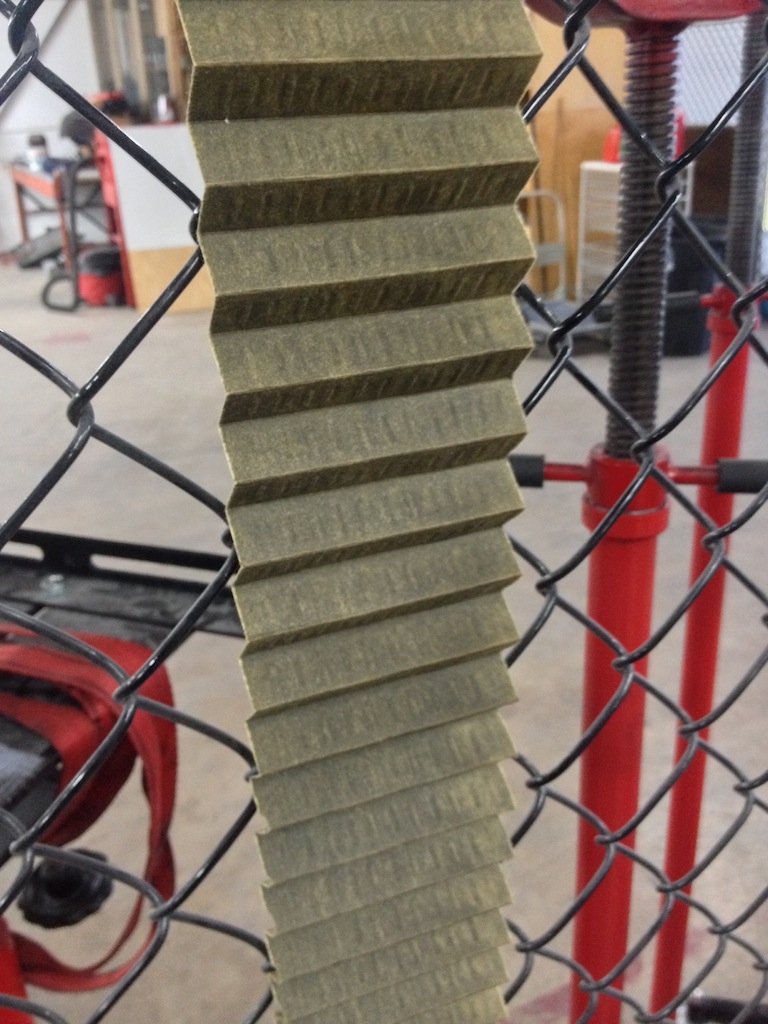

Yep, I did the belt replacement.

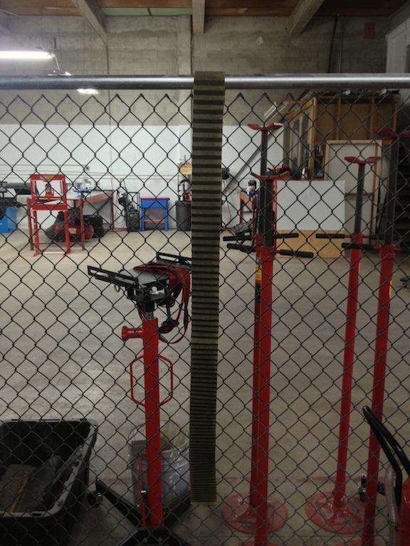

While putting leverage on the bar that is attached to the tensioner pulley, I somehow snapped off the nut on the lever. Fortunately you can put your ratchet right on the bolt that holds the tensioner pulley to get it to move if this happens to you.
The new belt was tough to get on. You have to make sure you get *every* bit of slack out before you try and loop it over the last pulley. I have read that heating it up with a hair dryer can help but honestly I don't think it is going to stretch that much since it is made to be pretty heat resistant.
Make sure you take pictures of exactly how the belt is setup before you remove it, the thing snakes around a lot
I don't think it is worth paying $390+tax for.
