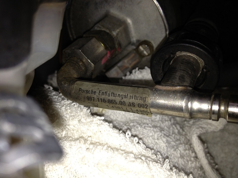

I figured out how to remove the coupler that goes to the bleeder valve pipe - instead of just one tab you push in to detach it like the coupler illustrated in the 996 GT2 diy, you have two tabs on both the top and bottom of the coupler that need to be pushed in.
The bleeder valve cap on the pipe also might be loose, so tighten it a bit before you start removing the filter. You can probably guess how I know...

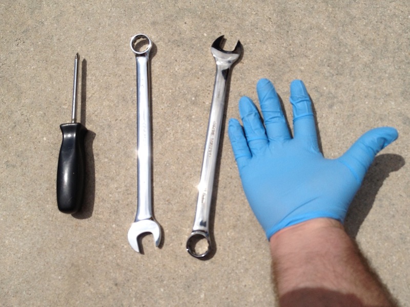

Tools are simple -- 2x 19mm wrench (I had a 19mm and a 3/4"), phillips head screwdriver and hands (ideally with 5 fingers):

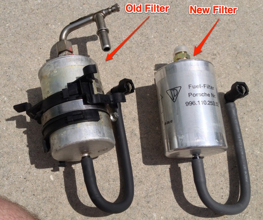

Old filter, new filter:

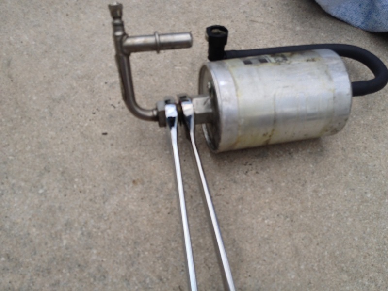

Once the filter is out, note the orientation of the mount and bleeder pipe so you can line things up properly when you put the new filter together. You don't have to be exact, just close enough. Now use your wrenches to remove the pipe. Once the nut breaks just a little you can just de-thread it by hand:
