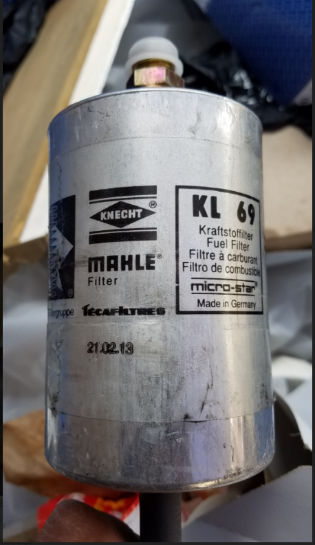

Well done Ben! going to give it a try in the next few weeks.Is the fuel filter the same as the 996TT? MAHLE KL 69 Fuel Filter
When I took the picture of the new fuel filter, I made sure the part number stamped on it was visible in the picture
996.110.253.52

Thanks for confirming Ben, Just did the one on my son's 996TT and it crosses over to the KL69 same part at 1/2 the price. I will get it from the dealer since I need the other parts you listed.
