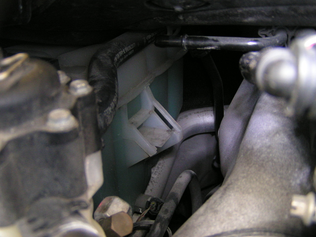

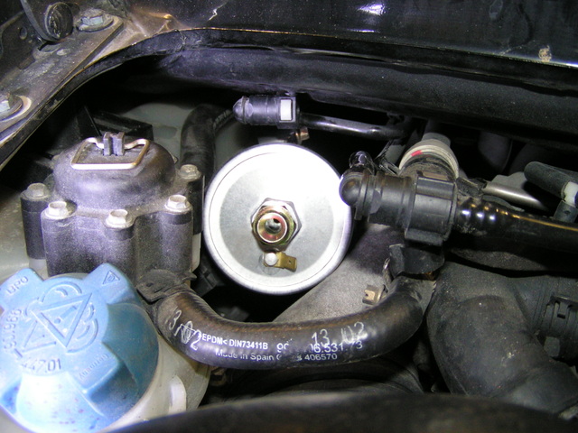

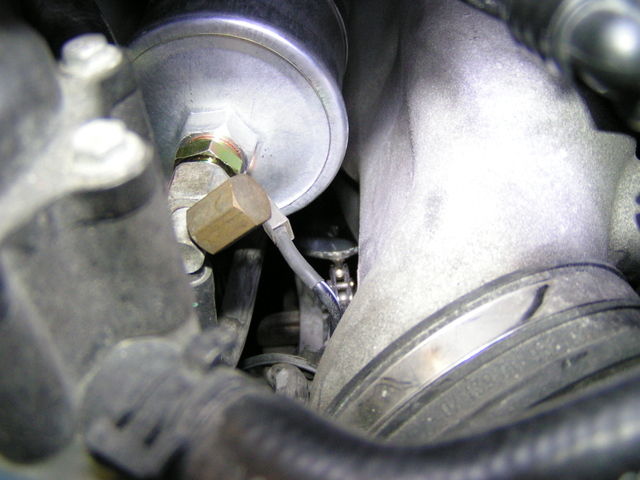

4. Now this one requires some force and is tricky and you HAVE TO BE CARFUL WITH IT!!! The filter is mounted to the Coolant Reservoir and I don't want you guys cracking it as a little birdie told me that it's not that easy to replace. Disconnect the fitting on the filter 19mm while countering with another 19mm or a 3/4 for these who might be tight on wrenches.
4 1/2. If you're wearing a baseball cap, you might want to twist it back as it will start to get in a way right about now.

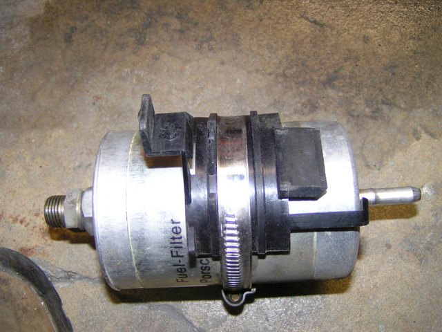

5. Now the manual tells you how to take the filter out while pulling the TAB forward, which is hard to picture so I took some pics of the whole setup for you guys to make it easier.

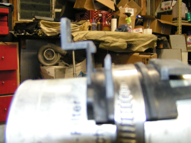

Here's the band that holds the filter to the black clip that clips into the coolant tank.
Here's to show you how it clips.
And here's where the "Assembly" clips into.

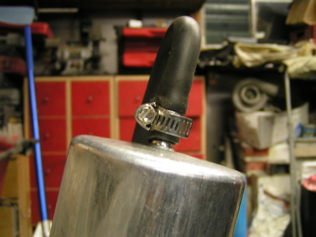

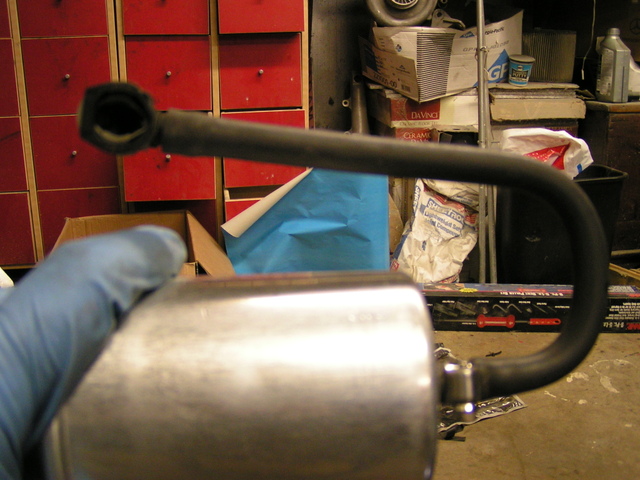

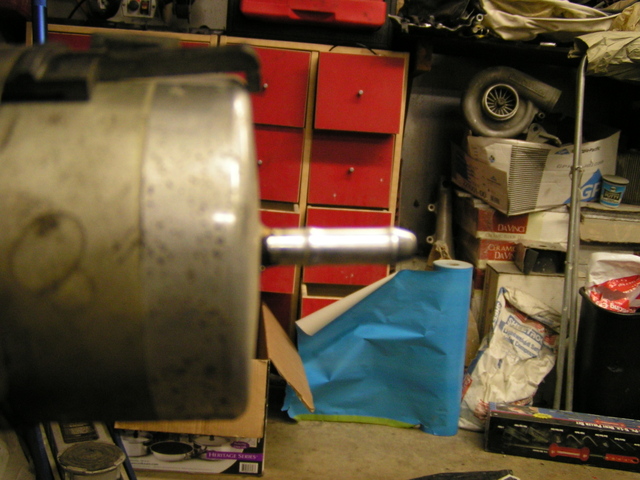

Now, when I got to this part, I realized that the filter I got was "affordable" but didn't come with the pigtail. Swaping it is tricky as the high pressure fuel line is heat shrunk onto the filter. Lucky for me the stock filter didn't have much of a "lip" in the nipple that attaches to the line as pictured below: WARNING, at no time, do not put any heat or flame close to the old FUEL FILTER as it might explode and cause injury.
So, I gently pulled it off while working it side to side (not to crack it) and swapped it over to my new filter, which had a bigger lip. Than I gently heated it after rinsing it in water and blowind it out,(where the connection is) with a lighter and after checking it is snug I put a clamp on it just in case. When heating it make sure you distribute the heat evenly and dont burn the rubber hose covering the plastic line.
Now, my buddy just pointed out that the clamp I used is not approved for European cars so If you use one like that make sure that your warranty is expired
7. Now you need to swap the band and the clip making sure you clock it right with the pigtail being straight up and the clip being at 7:30.
8. Here it is sliding into place.

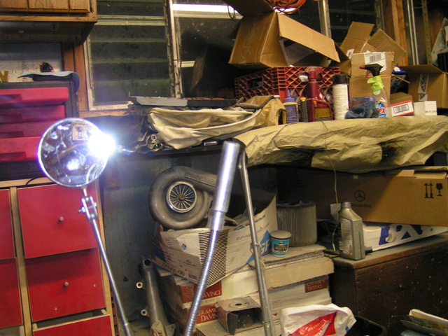

This is where I took out my handy mirror and I made sure I got the clip to engage into the slot.
9. Here it is clipped in with the lines attached, fittings tightened and the ground wire attached.
If you look closely enough, you can see my handy mirror checking for leaks behind the filter where the pigtail was attached. Make ABSOLUTELY sure there are no leaks, as the fuel filter is located direclty above the turbos and the manifolds, and you dont want your Turbo to turn into a Fiero. The car will run without the MAF but you'll need to clear the codes in the computer afterwards by disconnecting the battery.

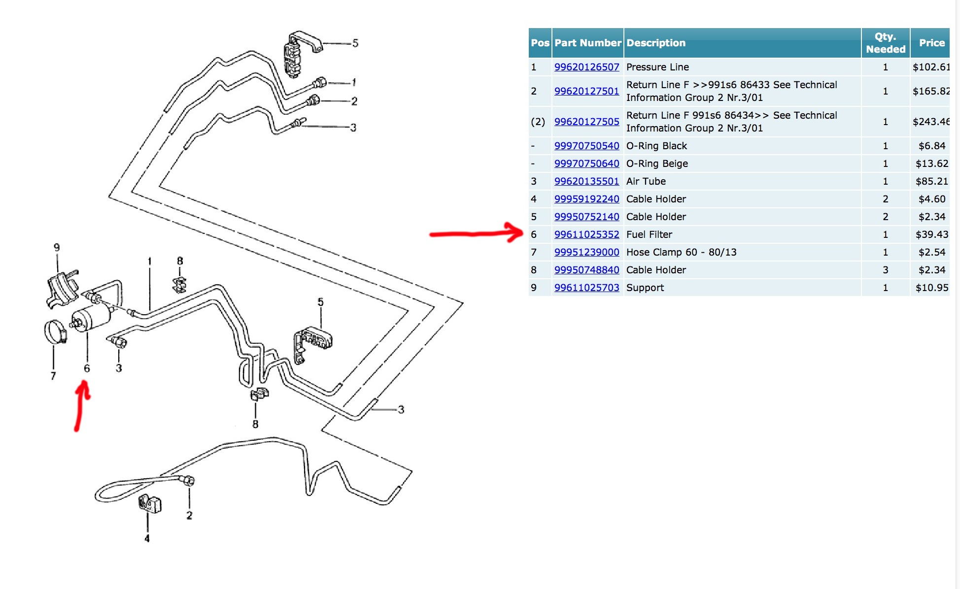

Nice write up! Thanks for the photos JP - what's the part number on the filter? You likely have it at your fingertips,,,
Old Sep 5, 2014 | 05:47 AM
jpflip's Avatar
Joined: Mar 2008
Posts: 2,807
From: Montreal Canada
Rep Power: 268
jpflip Is a GOD !jpflip Is a GOD !jpflip Is a GOD !jpflip Is a GOD !jpflip Is a GOD !jpflip Is a GOD !jpflip Is a GOD !jpflip Is a GOD !jpflip Is a GOD !jpflip Is a GOD !jpflip Is a GOD !
Yes sir!!! part#99611025352
