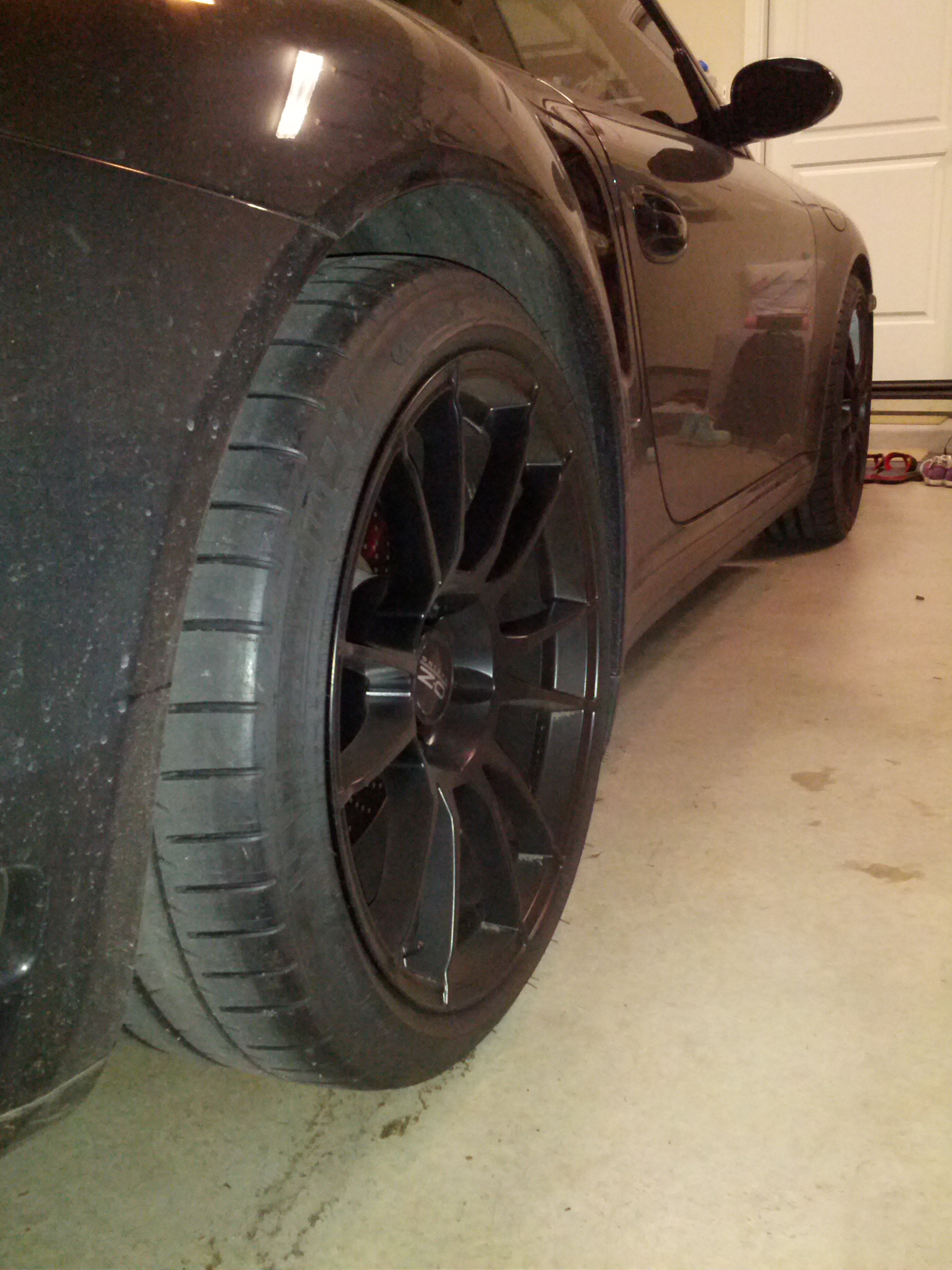

I have 19x8.5 (ET49) and 19x12 (ET51) Oz HLTs and had no problems at all. There has been discussion about differential issues, but - if at all - the problems would be caused by the choice of tires (diameter ratio, in particular), not the width of the wheel.
I stuck with the OEM size tires. The rear is slightly stretched, but not out of spec. So, despite going 12" in the back, I'm still on OEM size tires and safe.

1pennyshort, can you post a pic of your rear wheel so that i can see how stretched it looks on the OZ's.

Originally Posted by maverickdxb
thanks for the input guys!
Crappy photo, but it should give you an idea of the 305 tire fits.
Yea, IMO that does not fit properly at all.
The bead is in the wrong location relative to the side wall.
You would do better to find the proper width /diameter tire for that wheel width.
