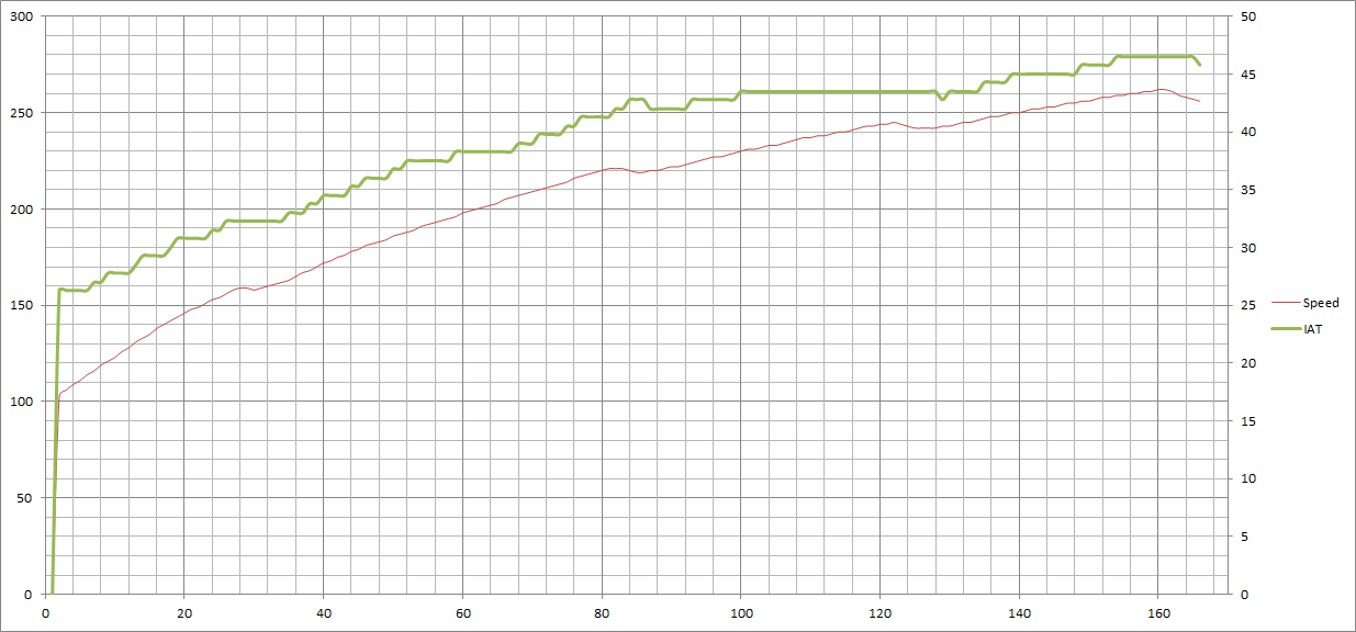

All this temperature logging is missing one thing: temperatures don't move a car. Load does. Having lower temps without checking if this is creating more load is not everything we need to know.
Having said that, here is my temp logging from about 100 to about 270 - traffic was in the way to do more. AT was 19 degrees C. IAT at start was 26 - I did not let the ICs cool off much before I did that run (did 2-3 pulls before).
BTW: these were 100-200 runs starting at 80 and this one I let go thru the gears after the main pull.
Max boost was 1.4 bar with 18G turbos going thru gear 3/4/5/6.

Old Nov 17, 2013 | 04:10 PM
  #174
GTRNICK's Avatar
Joined: Apr 2006
Posts: 1,677
From: London (UK)
Rep Power: 156
GTRNICK Is a GOD !GTRNICK Is a GOD !GTRNICK Is a GOD !GTRNICK Is a GOD !GTRNICK Is a GOD !GTRNICK Is a GOD !GTRNICK Is a GOD !GTRNICK Is a GOD !GTRNICK Is a GOD !GTRNICK Is a GOD !GTRNICK Is a GOD !
What coolers are you running?
