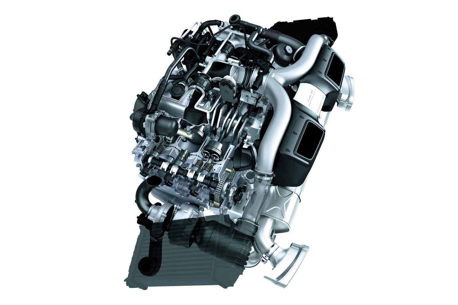

997.1 VGTs. 1.2 - 1.3 bar, but peaks were significantly above that... BTW, if anyone knows someone that fabricates aluminium end tanks for 997.2 ICs , pls let me know!
Apparently Porsche had noticed something too, because 99.2 engines have another set of CVs in addition to CVs built into compressor housings. See pic below:

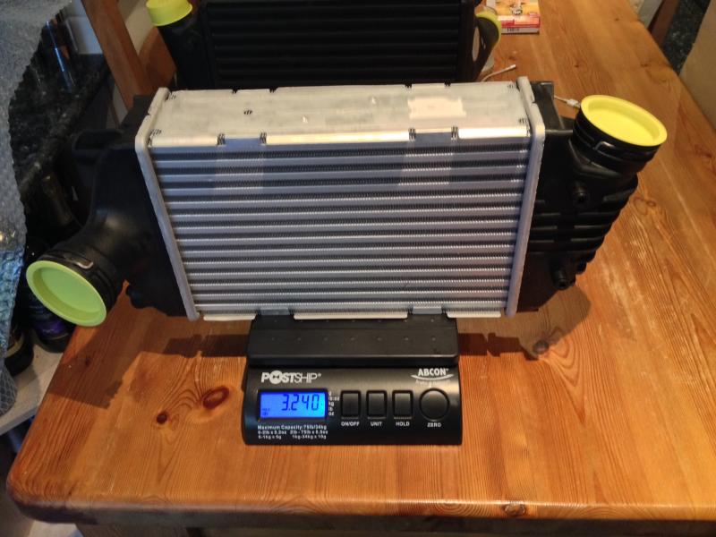

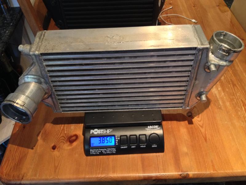

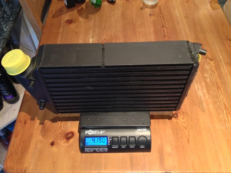

A little update! FVD sent me one of their AKG intercoolers and was kind enough to provide me with a GT2 RS intercooler for the test on the 28th which is next Monday.
I thought I would weigh them to see the difference.
FVD/AKG - 11 internal rows/12 outer rows
GT2 RS - 14 internal rows/15 outer rows
Aerospace core - 12 internal row/13 outer rows
