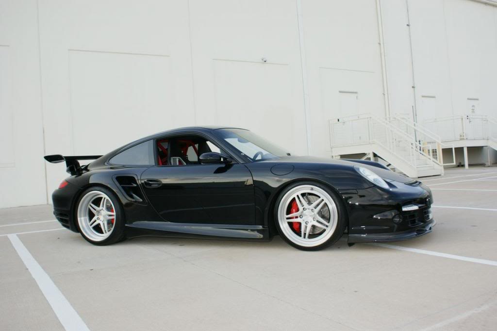

well are you looking for after market or just spacing out your wheels? I created the most aggressive fitments on 997TT 20x13 with 345 as seen above by triblk6spd . We can easily do 13 wide on back with 345 tires. just let us know your goals i can build it. Here my turbo also with 13 rears
