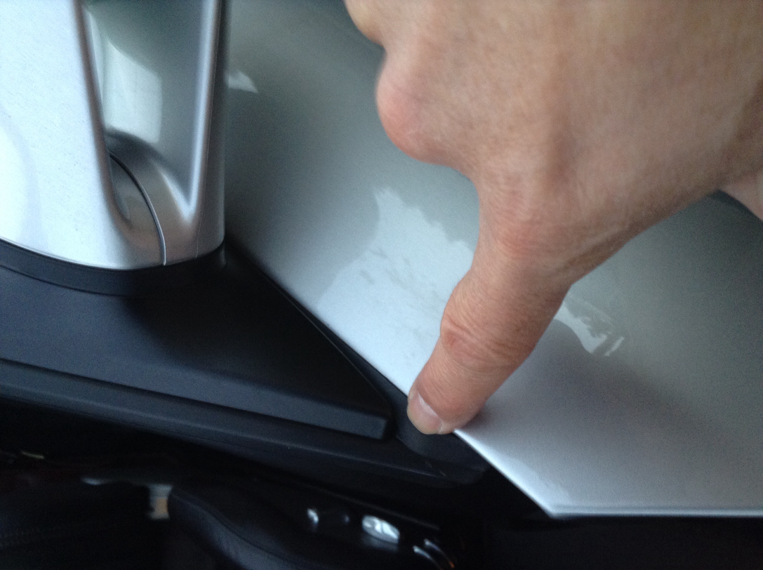

Sorry can't figure out how to upload multiples from my iPad.

Originally Posted by Jako
Hey Scott sorry for the delay. Here are the areas I can see to be potential problems?
Thanks! I will revisit the issue this weekend, but I am fairly certain that I have already taped over that area. But I will try again!

Spent some time today diagnosing this, and seem to have found the issue. I taped up the entire mirror, plus the door seal area that Jako suggested. Whistle went away, yay!
I then moved on to narrowing down the specific area. I started by taking off the tape on the door seal, and still had no whistle, so that left the mirror. I began taking tape off the mirror bit by bit, until the whistle came back. I then removed the rest of the tape and put back the section of tape I had just removed, and confirmed I had no whistle. Taking away that section again resulted in a whistle. So now I can cover an area approx 1.5" x 6" with tape and have the whistle go away. So what is that area, you ask? It's pretty much in the middle of the part of the mirror that faces into the wind. There are no seams involved, so it DOES appear to be the film itself! That's right, covering a piece of film, without covering any edges, eliminated the whistle. So it appears to be this "micro surface aberrations" issue that CrazyMD had posted about.
I am relieved to have identified the issue, and ironically don't feel compelled to have it addressed ASAP, now that I know what it is...I will have my detailer/film guy address it next time the car is in for work.
