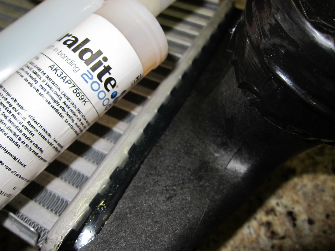

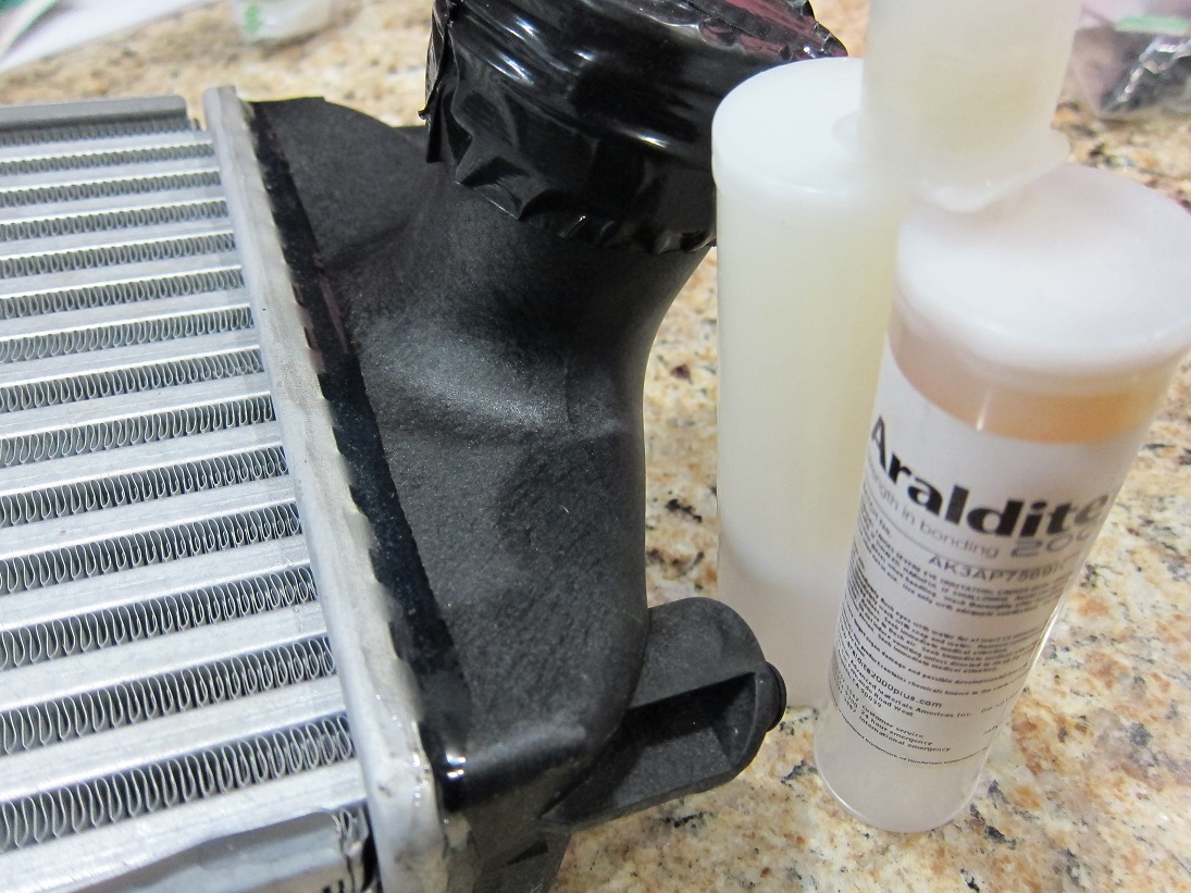

Unfortunately its not unheard of and the cooler will have to come out. Once its out, pull the tank by prying up the remaining tabs. Inspect the integrity of the rubber gasket. If its good, clean everything and reassemble and bend the tabs back down with channel lock pliers. Apply Araldite 2011 as depicted below and you've now bonded the tank to the core. I'd recommend doing all 4 end tanks while you're in there.
ID:	307034   Click image for larger version

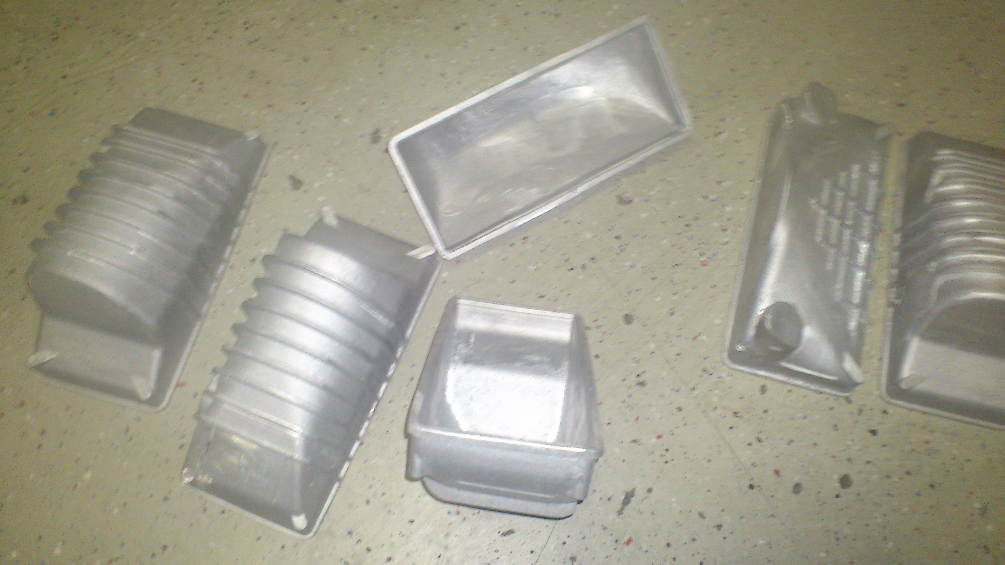

Hello
sorry for my bad english
i have make a other solution for the GT2 RS Intercooler

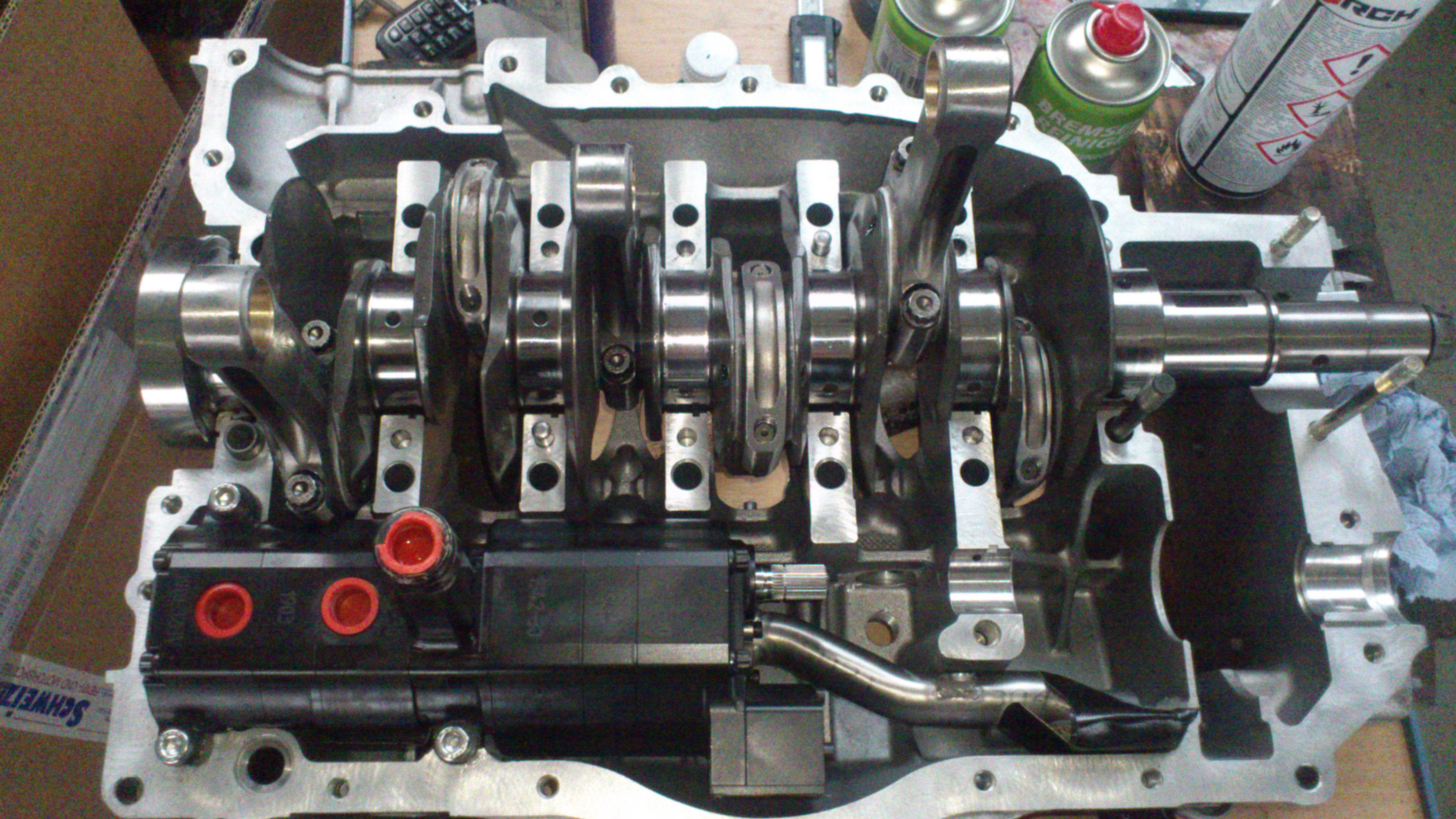

Hello,
Yes I have more, but I wanted to log into the administrator, so there are no problems, even for where I have written a message, can not respond, after 15 contributions only
Will still imagine my vehicle is a 997 turbo, but make it a new theme on
sorry for my bad english i make self and with translater a little bit
