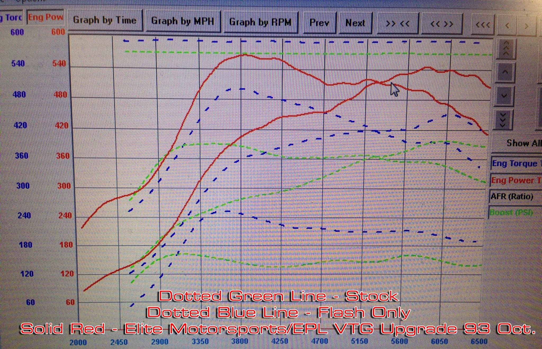

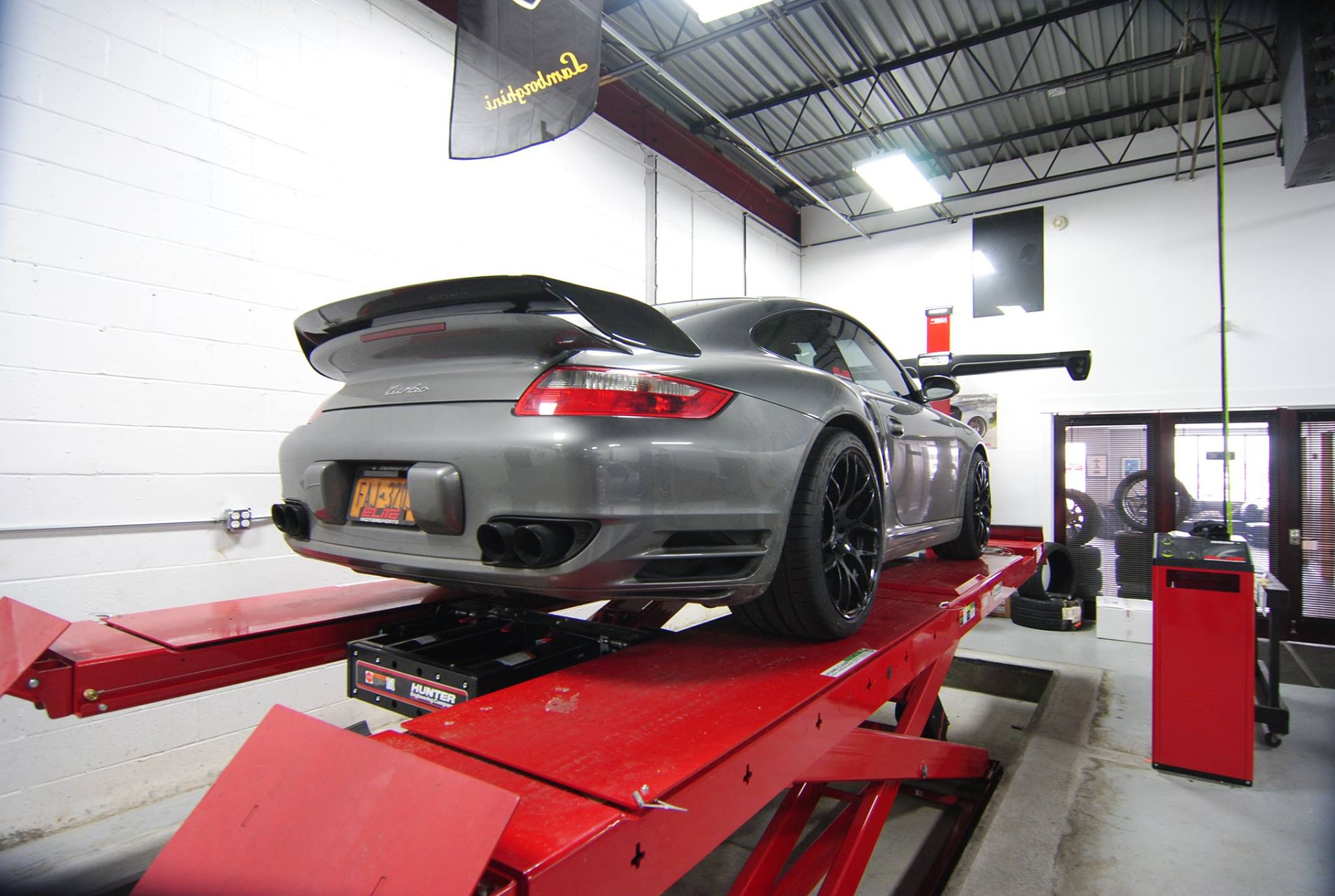

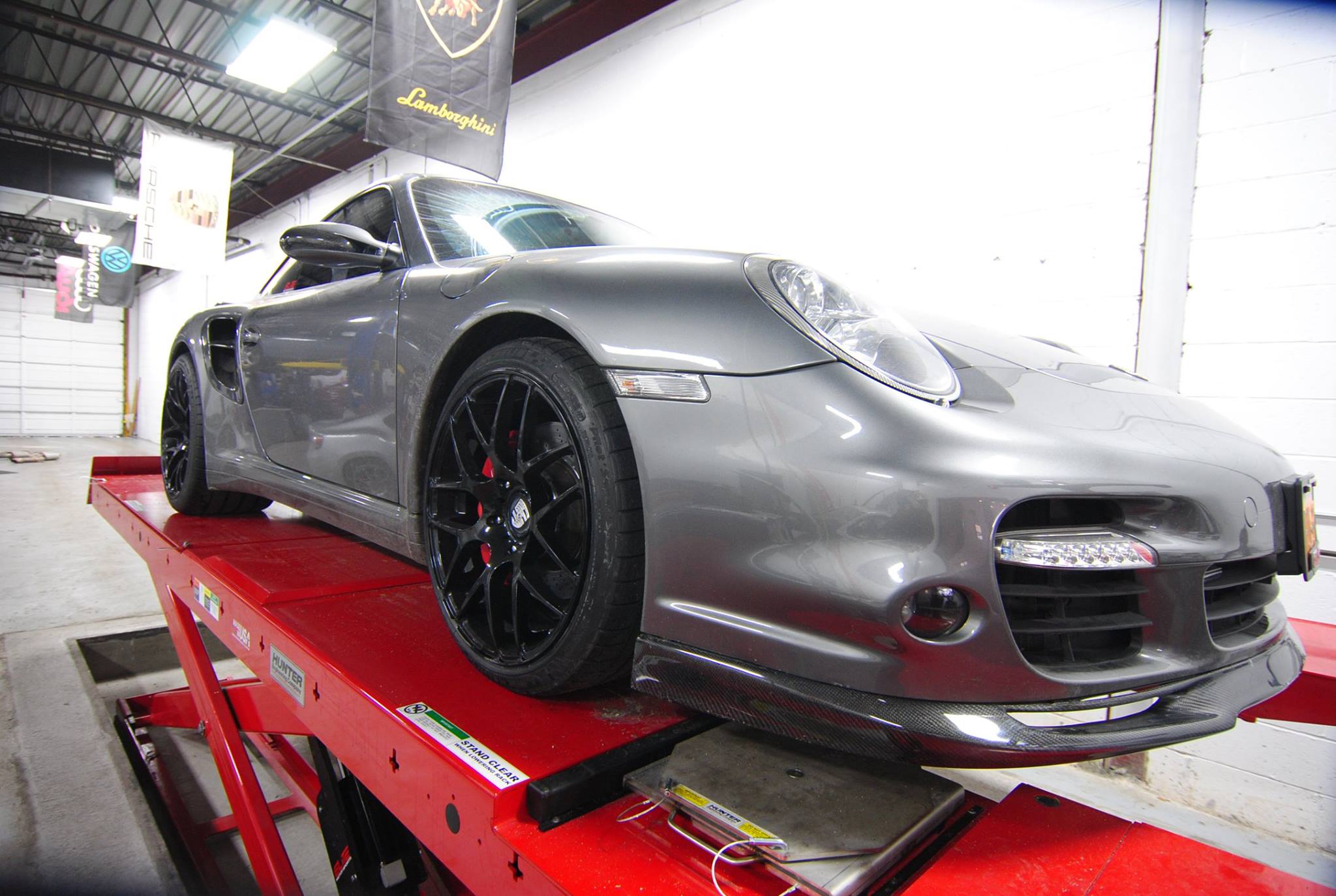

This has been a fun winter project. Thanks to everyone involved, especially Tony@EPL! Everything is buttoned up, we mounted the clients new wheels with some Michelin PSS' did the alignment and its ready for delivery this week. Car ended up making ~550WHP and 575WTQ on EPL's Mustang Dyno on 93 Octane. There are talks about doing a methanol system and potentially turning it up more but time will tell. These turbos have capability to reach 600WHP easily with supporting modifications.
Check out that spool! Practically NO Lag

Holy **** thats quick spool up. The car is making max power at 3800 RPM WOW!!

Like I said, with these turbos spec. to our liking we have practically zero lag compared to other setups . They spool/hit HARD. YGPM.

We installed a Aquamist HFS3 setup on this car and threw it back on the dyno and a re-tune at EPL (Thanks Tony!).
Here are the results! We are at 605whp (585 corrected) & 580wtq (565 corrected). If you're interested in this build please give us a call at 631.775.6634 or email sales@elitemotorsport.net
