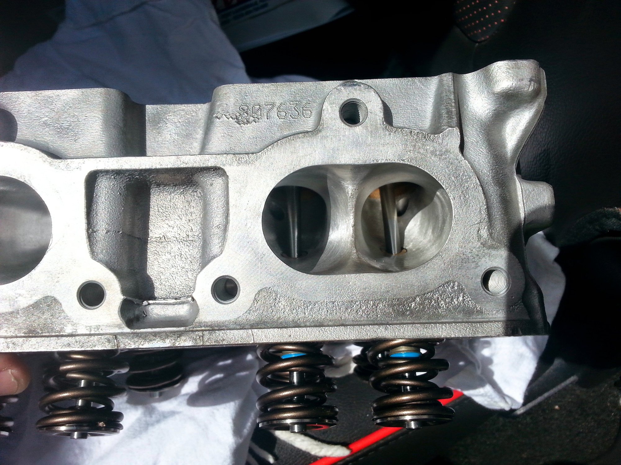

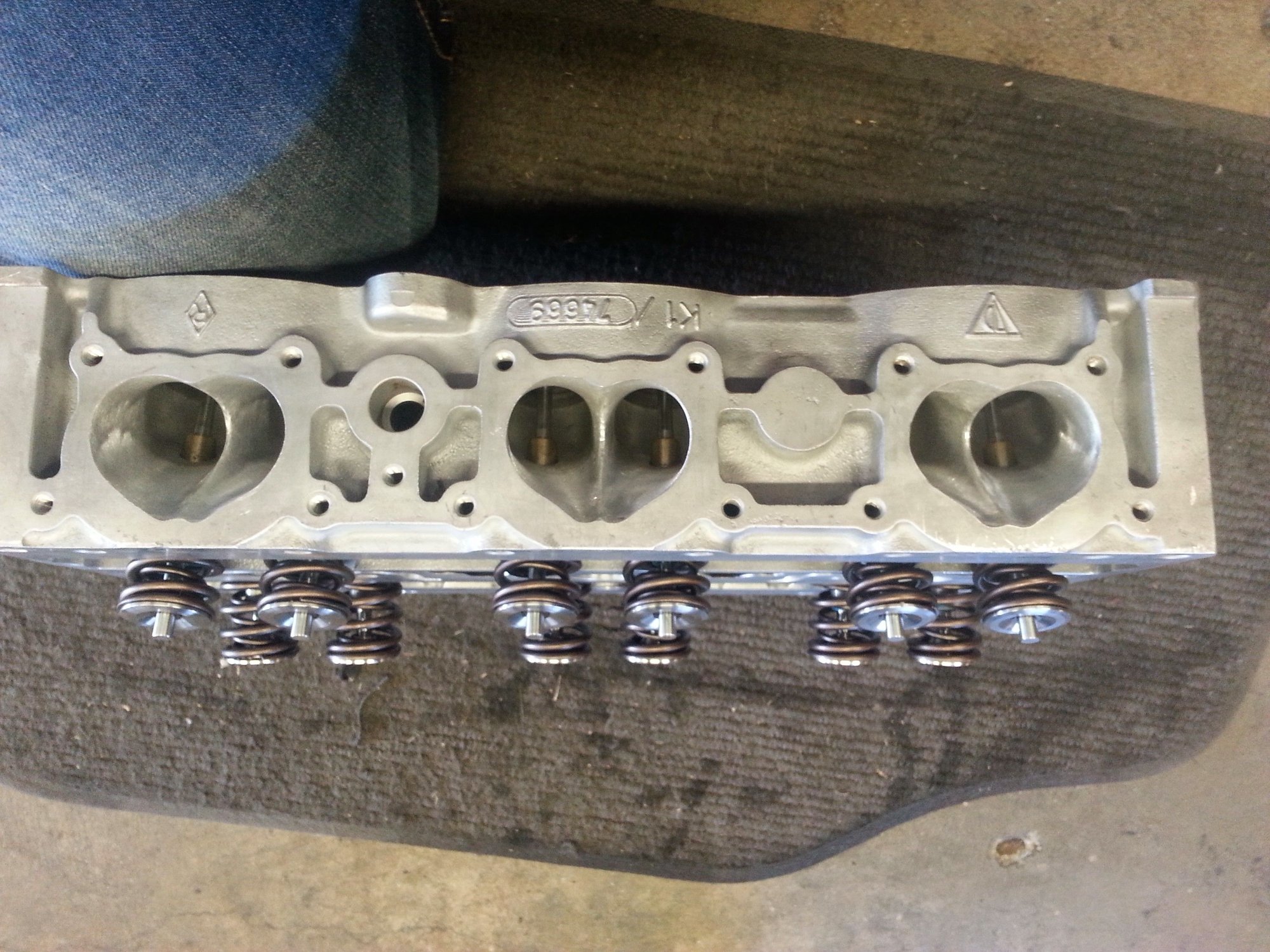

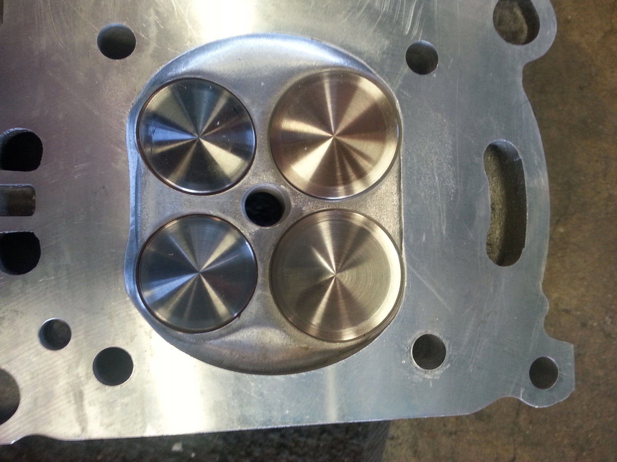

forgot I ever started this thread - well - I dropped a valve and kaboom; rebuild; back on the road ... breaking her in . 600ish miles .. wastegates .9BAR - feels pretty good; while i was down got the head done my Todd McKinzie - OEM TT flowed 220 ish after my head work the heads are flowing north or 320/330 something at .5" - also mated the heads to a custom gt3 intake setup by BBI.
hope she stays together ...

nice. what fuel pumps are you running. more info on the intake and heads !

Tood K - e85 setup... triple in tank - there is a saddle that goes around the in tank twins which - not sure which feeds what ... from the tank to rail -8 teflon/stainless lines - return -6 same.
Intake - Betim /BBI /IPD - This piece actually fit "direct" replacement with OEM - had to ditch the secondary air but side affects almost nothing even on cold starts - stacks 996 GT3 - the big volume part 997 GT3 - mated to IPD Plenum - 82mm TB
Heads - Todd McKinzie - chillest 1 man shop machine shop - port matched to 996 gt3 stack- intake valves -40mm - exhaust 34mm
I popped the intake mani off between the stacks and runners anything above 1 bar - strapped the runners down from 4 corners ... so far so good .. lil timid about turning her up ...
