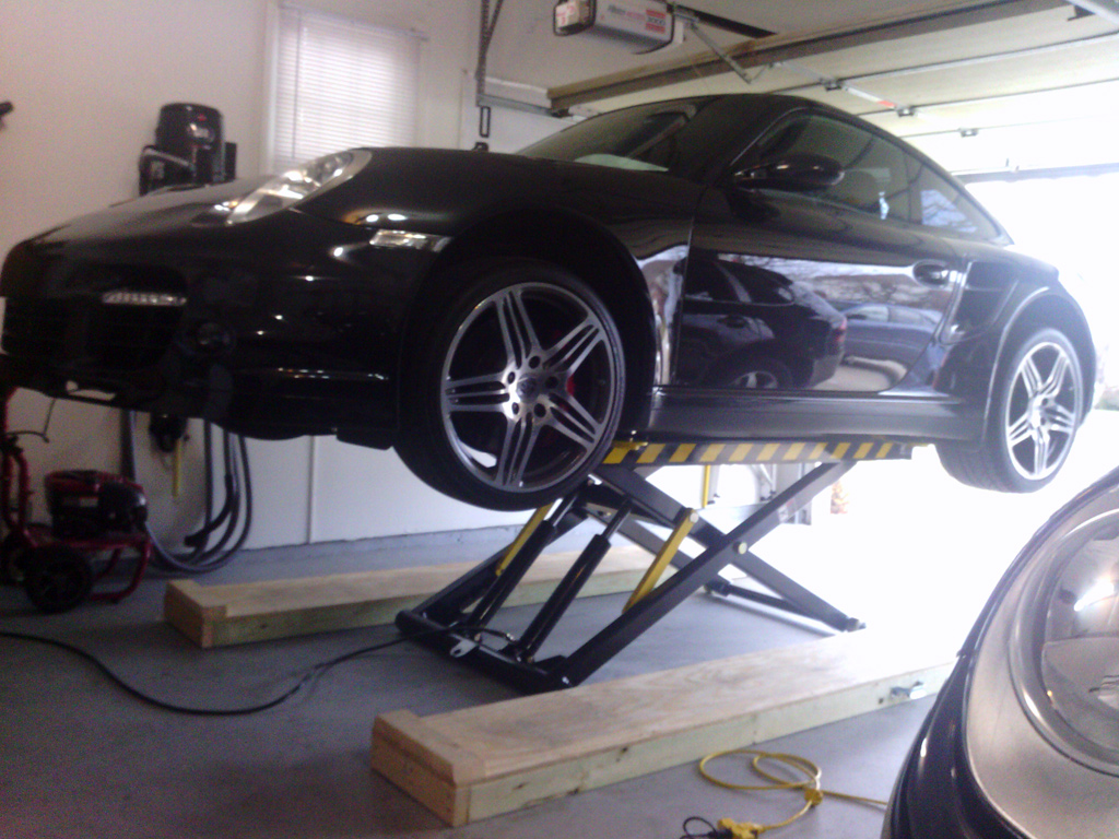

Wow! If you are not joking, that is the nicest offer I have ever had. I would love to learn more about the car...This is how I relax....tearing it apart and usually(hopefully) getting it back together
If you are NOT joking, that would be awesome! I posted a picture of my car on my new lift...likely not up to snuff for what you are used to, but goes up until it hits my garage door opener. The two nearest dealers to me here in central Illinois are Isringhausen Porsche in Springfield, and Autohaus - Porsche of Peoria...Both about 45 min to 1 hour away from me...Not sure if you ever go to them.
I have the new coils and plugs ready to go....The weather here kind of crapped out, so the cars are just in the garage....So anytime between now and early next year / springish would be fine....Car runs OK...just hesitates with heavy boost.
You can document anything you want about the car, and I am happy to help to the extent I can....
I have your email from other correspondence and requests you and I have had regarding my car....So we can follow up there if you are serious....
Either way..always appreciate your help with issues...Thanks!
DC
