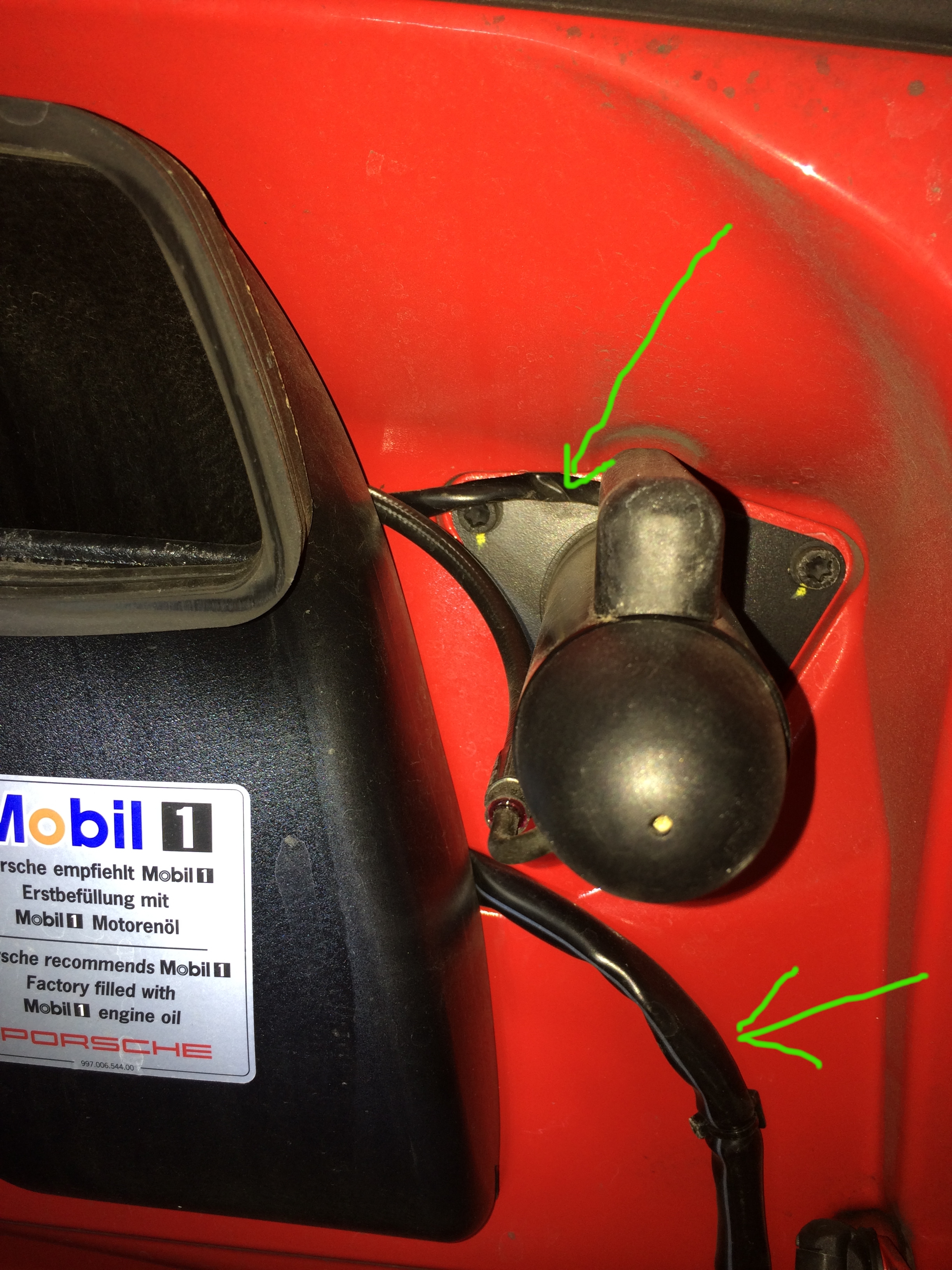

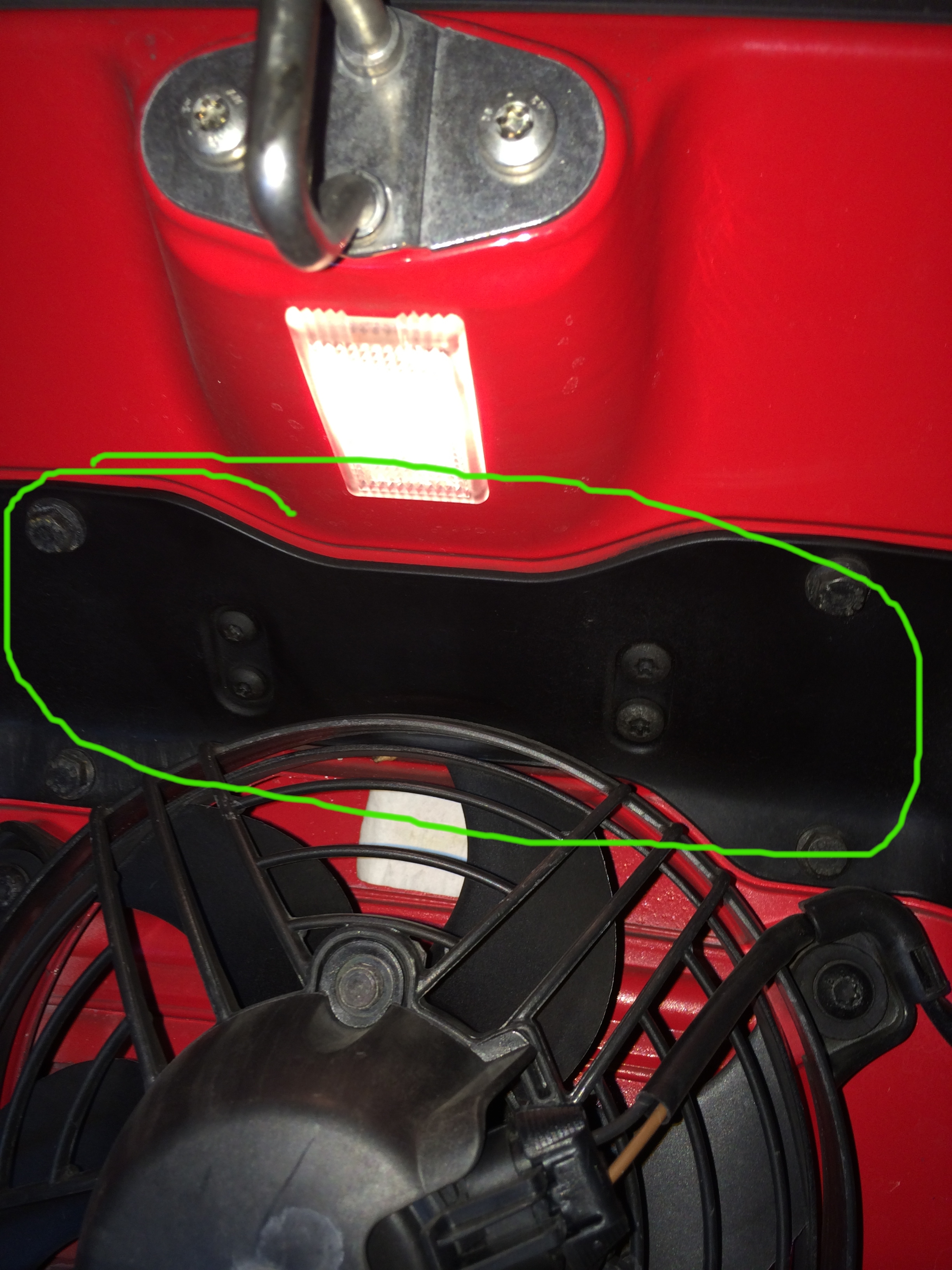

As for the harness, in the first picture is the dead hydraulic. I see 2 wires, a larger harness one, and a small one who's source is obscured. The bigger harness goes to this point in picture 2, but it looks like it might power the fan too? Is this the harness? Finally, how does one get to the motor etc, is it behind the plastic plate in picture 3?
Does anyone know of a guide for a 997, I found guides for 996 but never a 997.
