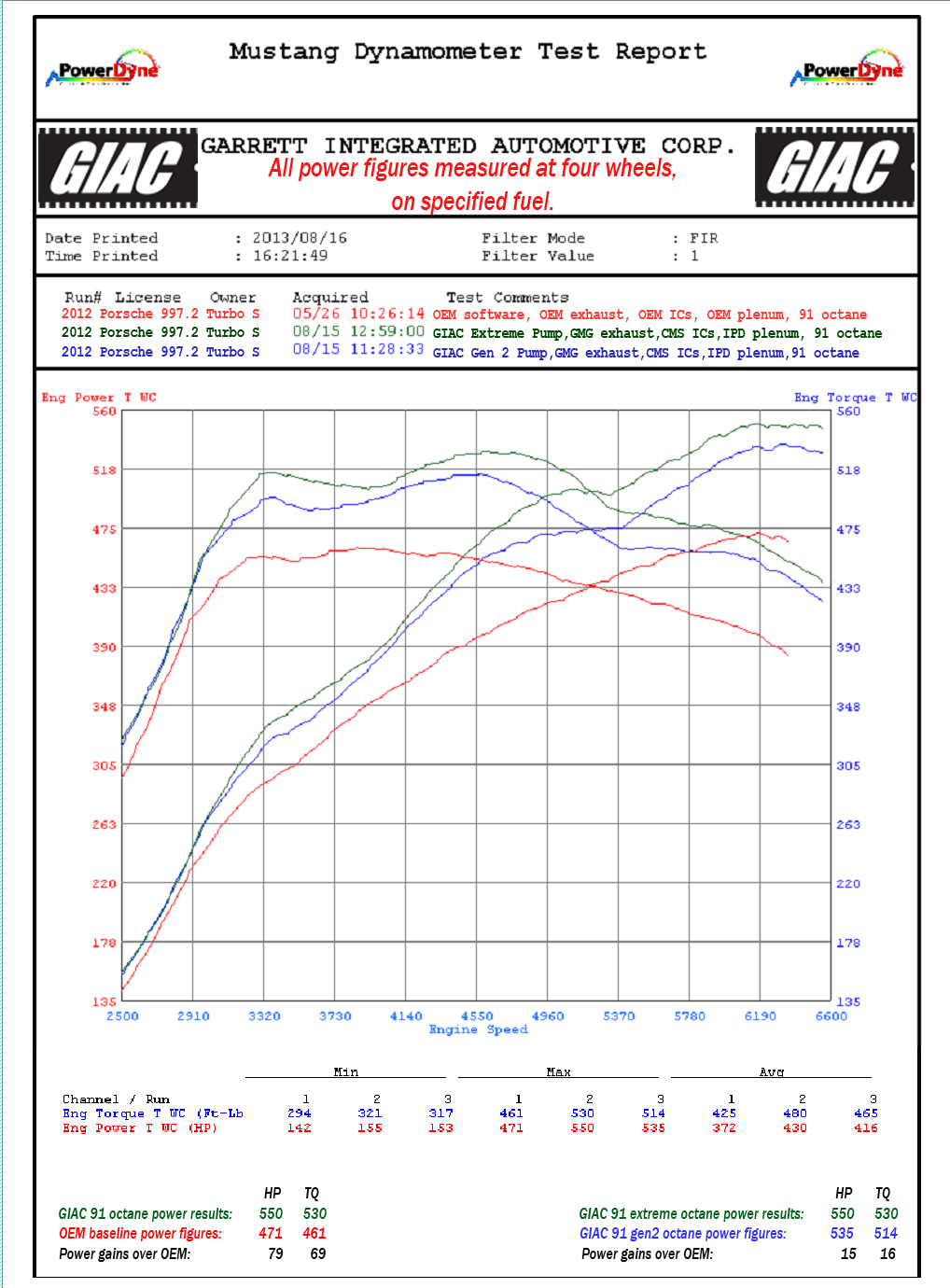

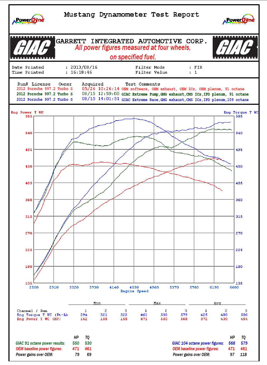

For what it's worth, the Champion intercoolers are the only added requirement for our "9-second" file. We recently had a Turbo S on our dyno that added the CMS intercoolers and received the corresponding file upgrade.
Here is the before and after dyno, the first being a comparison with CMS intercoolers and the upgraded file on 91 octane, and the second being the results on 91 and 100 octane.
Tom likely has all the specific data, but from what we see on the dyno and through data logs, the CMS intercoolers will produce lower IAT's and have less pressure loss than the 997.2 intercoolers. This equates to added timing advance and more boost at the same duty cycle. These results are further amplified as you step up to larger turbos.
