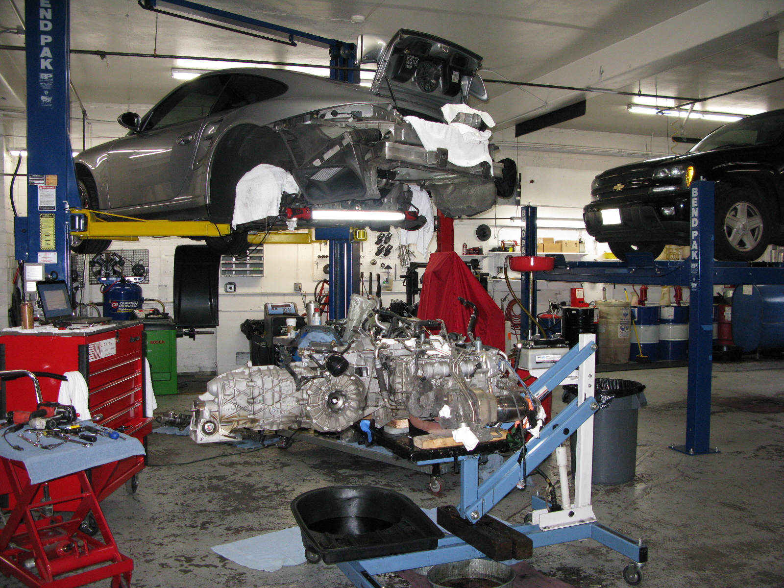

While my engine is out also replacing the 8 coolant fittings that are know to be loose and cause major coolant leaks. My mechanic said 2 of the fittings pulled out very easy.
In one of the pics you can see the power steering lines that has been replaced.
This is the problem with them, I am getting mine welded in.
This may have been a blessing to repair now instead of when a huge blow out happened.
New fittings I am having welded in not JB weld.
