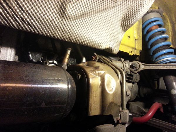

So I did it just like Dr. Rock suggested.

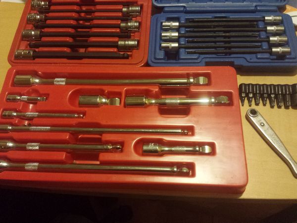

My best advice would be to order the correct tools before you start -wobble extensions and sets of long ball allen and torex bits are a must for this job.

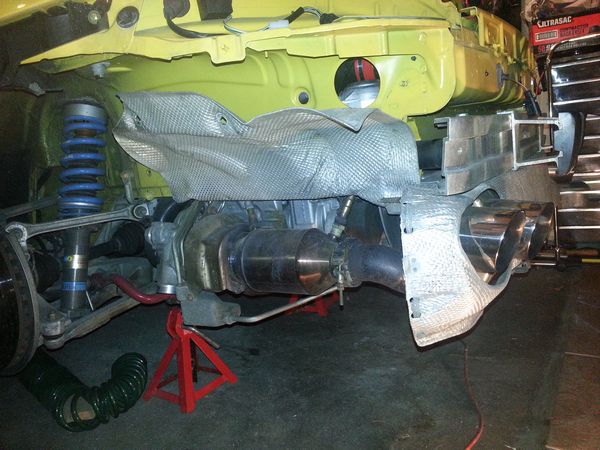

I didn’t drop the engine or move any oil or coolant pipes in order to get in to spark plugs .

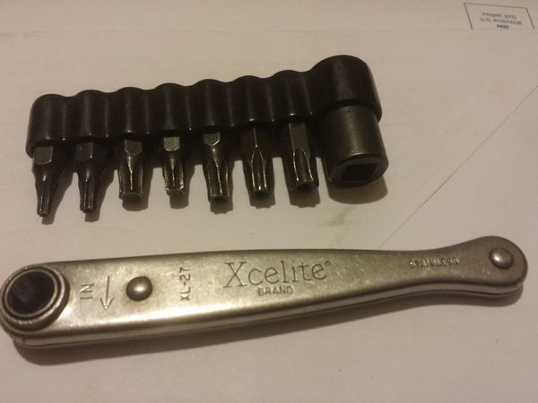

All project was about one spark plug –first on the driver site facing the front –it took me more time to do this one spark then to change other five. I used my tool (see attached picture) to remove driver site actuator.

To the previous post...On the driver's side, I was able to get the plugs out without removing the actuator. It is actually easier (much) to lower the motor....Two 18 mm nuts and a stand....That actuator is NEARLY impossible to remove...and install. Just FYI. Also looks like you had all the right tools based on the photo!

4 plugs can be done in less than an hour, the remaining two took two hours eacheven when you have removed the obstructing parts
. Getting some of the coils back in was another big issue if you don't remove all of the obstructions. The boot would hang up in the spark plug hole making it impossible to push the coil in without risking damage. In the end, it was very educational. I would definitely lower the engine next time.
