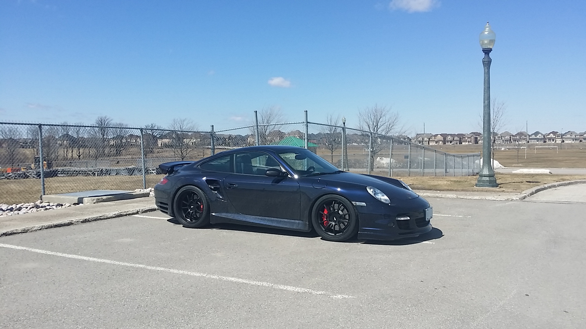

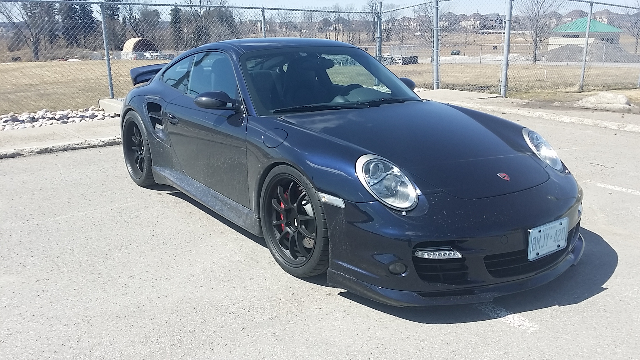

I followed this thread a bit in regard to offsets for 245/325 tire sizes as I was ordering wheels and here is what I ended up with.
Advan RZ-DF
19x8.5et40 245/35/19 Michelin PSS
19x12et50 +5mm spacer 325/30/19 Michelin PSS
Advan RZ-DF
man !!!!
you look sooooooo gooooood I'm serous
Advan RZ-DF
Looks perfect DOOBEE! those are the wheels i want on my car as well hahah

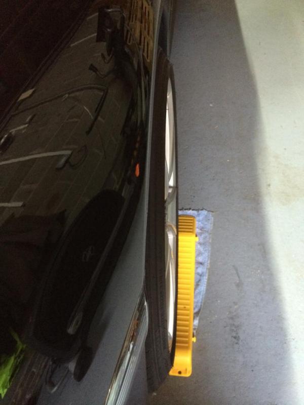

Just bringing this thread back up.
I've got a 997 Turbo gen 2.
Just bought GT2 RS centre lock wheels, front 9 x 19 ET47, rear 12 x 19 ET48.
Will I be okay running 245/35 Cup Sport 2 on the front or will they stick out too much past the fender?
Picture below is a 997 Turbo with GT2 RS wheels like I have, he is running stock size a little stretched, 235/35 and a PSS so not as chunky as a Cup and they stick out a little.Heplans to get 245 in Cup once he has GT2 arch extensions.
I want to avoid the RS stick on extensions if I can, do you think I will be okay with 245 Cup or shall I use a 235 just in case?

Gt3rs wheels on one of my old turbos, the backs do stick out a bit.
