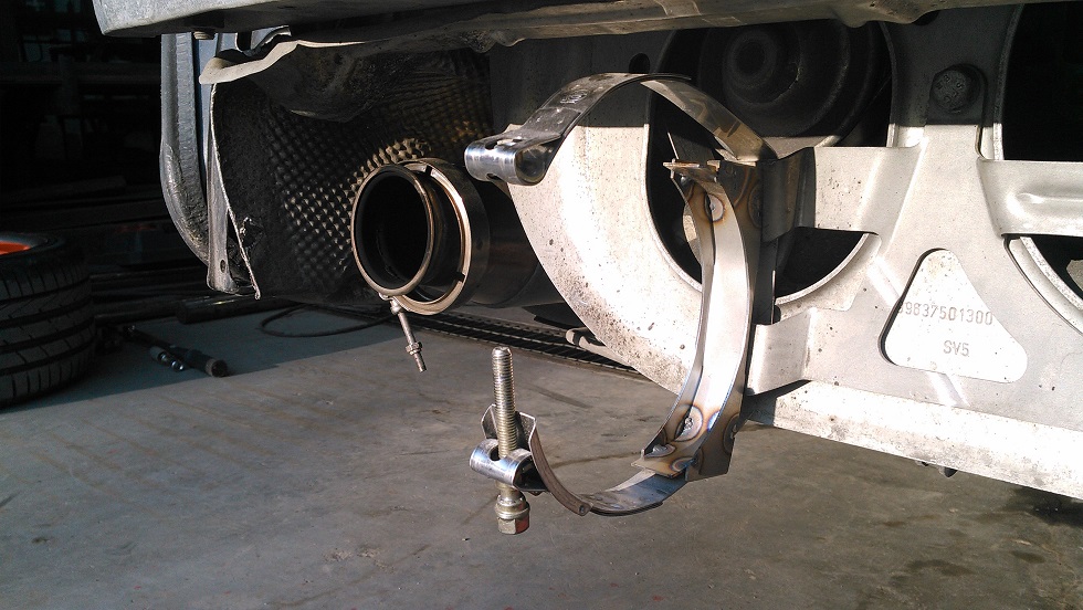

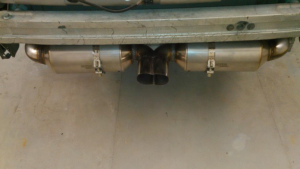

Thanks! I got a new "tailpipe" made yesterday. While that merged one was a nice idea and a necessity because of lack of space, the material was too thin and started to pull & twist. So back to twin pipes, still with a merge. Included also a pic of the strap and support. Stainless, laser cut.
