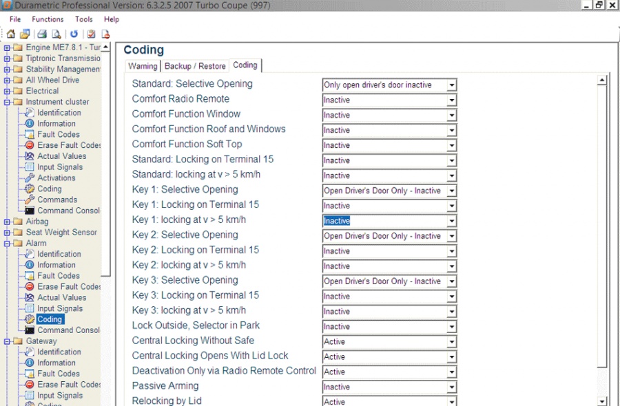

OK...So I bought a Pro Durametric and have been pleased with the product. The support...not so much.
At one point I changed a setting in my car to lock the doors automatically at > 5kmh (setting selection only 5kmh...no options on what speed)... This setting has options (ACTIVE)...or (INACTIVE)...pretty straightforward.
So I do not like the option, because I always have to pull the handle twice to open....So I decide to change it back. I change the setting to (INACTIVE)....and every time I start the car, to goes back to active??
I sent my question and attached screen capture to Durametric tech and cannot believe the response?? This seems simple...After $700 for a cable, I would expect more....But at any rate...anyone have any thoughts?

For one of the modules ( I think Gateway, or Instrument Cluster) , when you are done making changes, you do have to go to the "Command" section and choose RESET ECU/DME...And the lights blink and it beeps. I have tried that also...It just is not writing, or if it is, it keeps switching back to active.
So I change it to INACTIVE.....Go off that module to another module...Come back to it, and it still shows INACTIVE as it should. After I cycle the key and reconnect...It is back to ACTIVE. Tried a dozen times in different order...no luck...
I was real enchanted with the answer from tech though. That was very helpful. I guess that means go to the dealer and use a PIWIS??
I could understand on some of the complex settings, but locking a door when the car drives seems remedial??
Thanks
DC
You pretty much have a process for connecting which requires the key in ON position. If you cycle the key at all while connected, the software disconnects and you have to start over. I am sure it is something quirky and eventually I will figure it out
For now, my solution was...I switched keys to my number two key ...as this feature is programmed per key...So key 2 amd 3 were still set to inactive...That was my easy/lazy/quick fix!

I was hoping we figure this out at some point, Like you I've been trying to mess around with the key settings (Same thing, Key #2 is good, while Key #1 requires a double pull)
Just ran to try it once more and it seems like I can replicate your issue.

Also...Just went out and tried the key thing again. I removed the Cluster fuse row B first fuse for 10 seconds without the key in car....supposedly resets gateway/ecu?...Then cycled key and connected Durametric....Set to INACTIVE for key1....Then went to cluster and under Commands...chose RESET ECU..Twice for good measure. Turned off...unplugged....turned on and connected Durametric and it appears to have stayed this time? Have not driven it yet, so that will be the test...but at least it did NOT revert back to ACTIVE...
