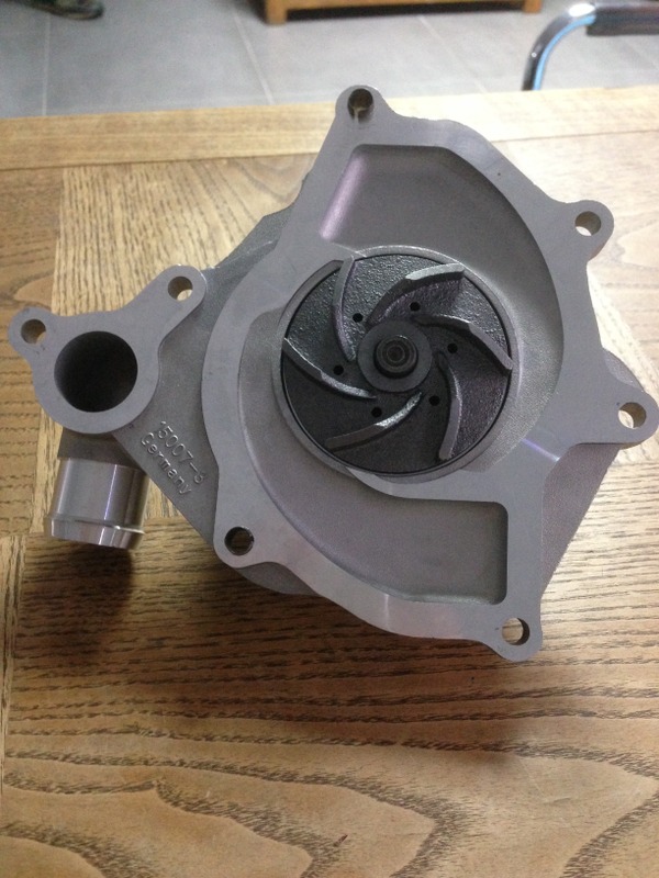

Hello guys,
During one of our engine inspections, we noticed the water pump propeller blades were broken, blades were made of "plastic" material.
After some quick research, we found that water pump is upgraded by Porsche and new pump has "metal" propellers.
I highly suggest to change this part as soon as you have a chance.
New part number: 997 106 011 71
Here is a picture of the upgraded pump;
Cheers,
Emre

so what years were "plastic" and what were metal w/ the new part?

I've heard this happening to 996 turbos as well. Safe to assume previous generations were also plastic?

This is interesting that Porsche now switched to metal impellers on the TTs. For my 928 it is recommended to "upgrade" any metal impeller water pump to plastic because in case of failure the metal debris will eat into the aluminum engine block like a hot knife into butter and causing major damage. Sort of a lesser of two evils...chasing the reason for an overheating engine vs. a badly damaged engine block.

I don't know exactly which years are plastic but all the cars i saw here (07 and 08 models) were plastic type.
It's better for everybody to check theirs during a service look up.

Replaced mine due to bearing failure 4 months ago. I would assume that all new pumps have metal prop blades.

Porsche still lists that part number as having composite blades, there are whitebox OE manufacturers that do make that P/N with metal blades.
