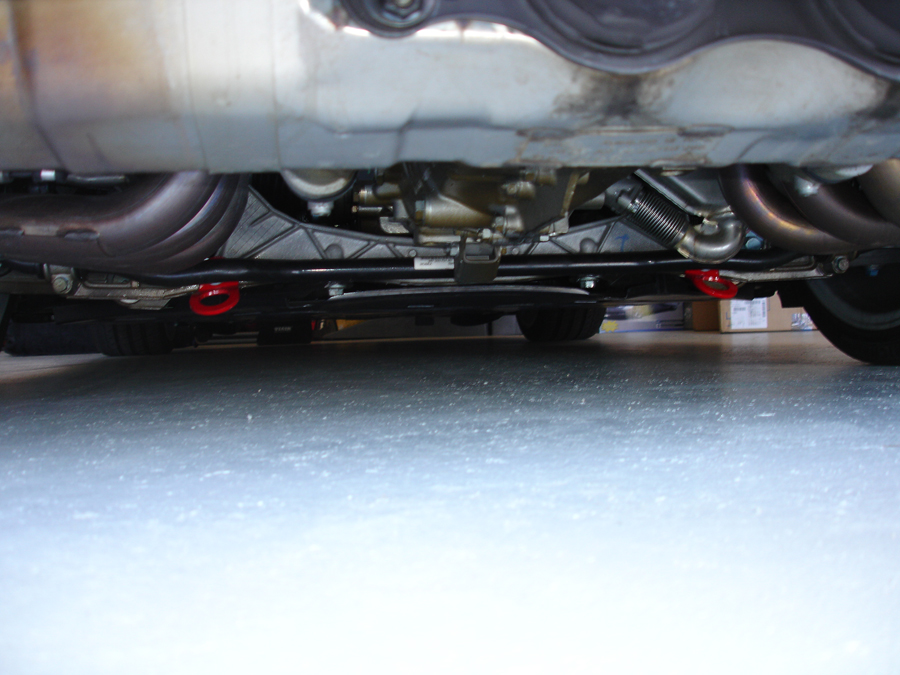

Ok i got the tie hooks...now question i have is which bolts to connect them to. The instructions were clearly minimal and i have searched and seen pictures from two different locations. Some people attached them to the bolts behind where the rear sway bar "bends" near the inside edge of the control arm/lateral arm. Others have attached them closer together with only about 1.5 feet in between the two tie downs under where the headers attach to the engine. Im thinking the outer points are correct but Thanks for the help.

My car is in the shop, but found this pic of where I attached mine
http://www.rennline.com/images/E04-2.jpg
there are 2 bolts under the sway bar.
This is a GT3, but location is the same
https://www.6speedonline.com/forums/...p;d=1227368493

Perfect thanks.
Yea if you look in your second link it looks like some people have used those 2 bolts inside of where the rennlines are mounted.
