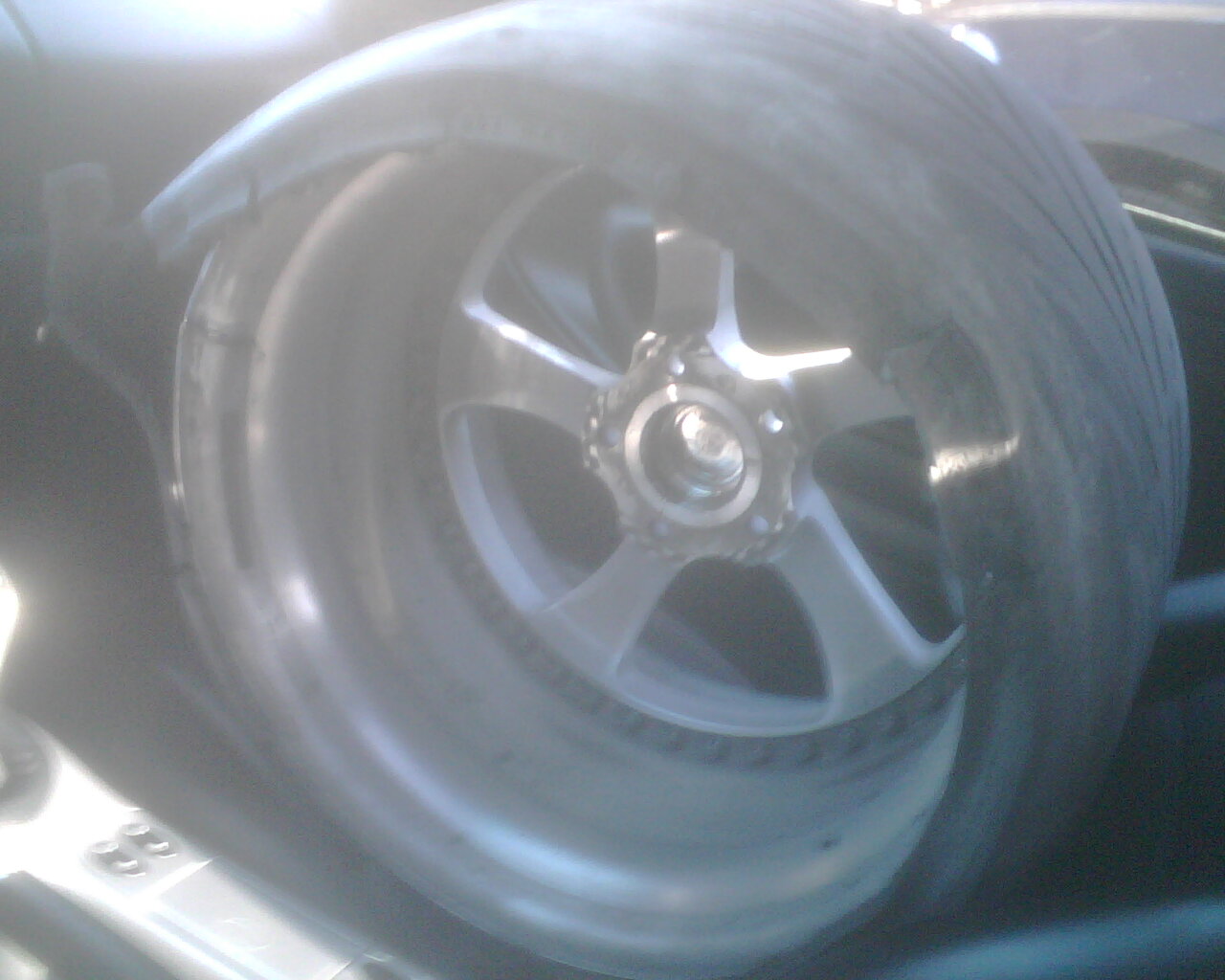

Had some 19'' HRE 3 piece on my 993 tt which requires very low profile tires kinda like 20" on a 997 tt but got a flat & bent the rim slightly ,not sure what happened 1st the flat or the pot hole to cause it ,but no probs with my HRE p40 ran them for several years 20'' on our SoCal roads which have to be the worst around.

3 piece wheels are weaker than monoblock wheels.
the strongest wheels in order of strength would be
forged magnesium monoblock
forged alumunium monoblock
2 piece forged aluminium (think bbs lm)
quality cast wheel (think gt3 rs wheels)
3 piece wheels
champion makes the strongest wheel for porsches (their magnesium MS61 is the strongest wheel available for our cars).
my champion ms61s sit on toyo r888s... i drive a lot... through manhattan, brooklyn , long island (we have craters not potholes), and ive hit a few hard enough that caused my alignment to be screwed up.. no issues... at all..
even with my oem gt3 rs wheels ( i remember hitting a monster pothole this winter and nothing happened).
oh , the OEM 997 turbo wheel is forged and is virtually indestructible.
(quality) three piece forged wheels arent as forgiving. when they bend or crack, its almost always from the inside barrell. the trick is to either run a larger tire and dial out negative camber.
my 3 piece forged wheels... cracked... 19 x 12. i replaced the inner barrel with a narrower one (19 x 11 now) and havent had an issue since.
