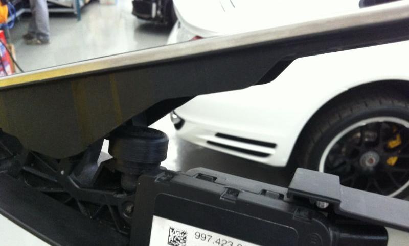

PDK, disabling automatic upshifting in M mode (disable kickdown switch)
Hi all,
I am racing driver and during the last seven years I have participated in all racetrack events of the Porsche Club of Brazil (and others private track days), always driving Porsches with manual gearbox.
Recently I bought a 997.2 Carrera S PDK to drive in manual mode, but I did not like the PDK system shifiting gears up automatically, especially in the middle of corners, leaving the car without traction.
With a simple change in the accelerador control the car is now improved for track days (only upshifting).
I removed the original kickdown switch and installed a fixed hand made part, with exactly the same measures of original piece.
The electronic pedal remains the full throttle, but stops before sending the signal to upshifiting.
Now I can control the gearbox to use all 8K rpm of engine, using the paddle shifters steering wheel.
The system is similar the new 991 GT3 PDK-S without kickdown, and can to be installed in any model Porsche PDK.

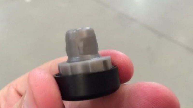

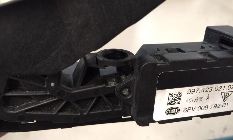

I did not find on the international market a software to disable electronically the kickdown function of PDK. There are several options for automatic models BMW, Audi, MB, etc., but not for Porsche PDK.
The kickdown switch of PDK is only a mechanical click, and I drove the car without this switch. I have no doubt that the upshift is generated by the end travel of potentiometer that control the electronic accelerator.

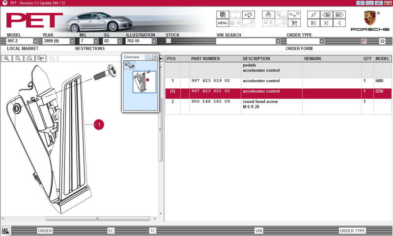

To remove the accelerador pedal is just a philips screw medium size and disconnect the connector of the electronic system.

In PDK, the kickdown button is a mechanical click (with spring, wireless) and its function is only the driver to know where ends the throttle travel, and begins the usual function of any kickdown.
I drove the car without this spring button and the function 'kickdown' remains the same. This function is controlled by potentiometer that controls the electronic accelerator and we have no access to it.
That is the reason to stop the accelerator pedal before it sends the 'kickdown' signal to electronic system.

Understand. So you've effectively installed a clutch stop for the accelerator pedal. Would be tough to just create one from stuff lying around.
