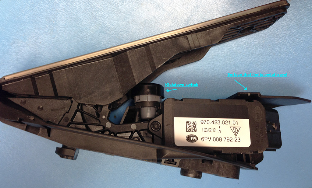

From what I've researched, there seems to be a physical button under the gas pedal that activates the kickdown when its pressed (which would be at full throttle). There has to be a way just to deactivate the button; either with software, physically removing the button, or simply unplugging it. These are just fantasies, I have no actual clue how the button is mounted/powered.
Edit: Found a photo.

Maybe easiest compromise is to mash the throttle without going all the way down to the button?

I can prevent the kickdown with my foot, that's not the issue. I'd just like to remove this feature if possible. Just like modifying anything to suit one's taste.
Originally Posted by Zero911
I always thought the PDK doesn't let you do this so that you don't lug the engine and cause damage.
Its the only car that does this. Other dual-clutch transmissions, such as my GTR, do not do this. In cars of this caliber, sometimes acceleration in the proper gear is just too violent for how I'm driving at the time. The downshift just takes too much time and makes unnecessary noise.
Anybody have a suggestion? Maybe a software tune is in the works? Button can be unplugged/bypassed, etc?
